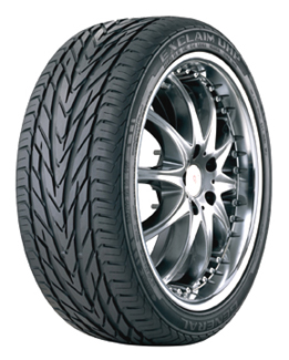

Just curious if anyone has given the General Tires Exlcaim a try. They are considered an Ultra High Performance Summer tire. You can get a complete set for like $550 from Tirerack.com for 245/35/19 and 275/30/19. I was thinking about giving these a chance since I burned through my Toyo T1-S so fast.
Attached Thumbnails New Tires...read and recommend please-exclaimuhp_3q_uv-property-original.jpg
