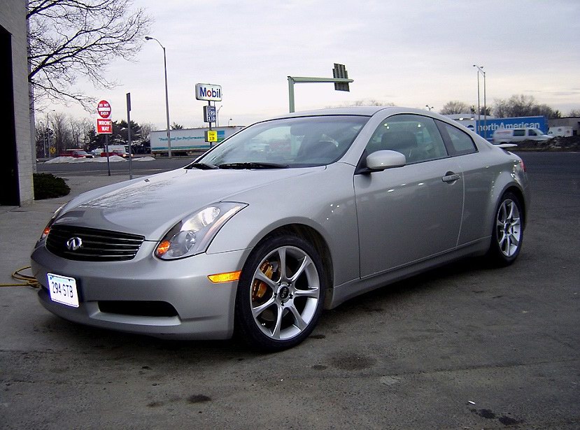

17's are much less expensive. I run 18's on my G (Pirelli SnowSport 240's) and the difference in price per tire was a lot. Since my stock rims needed to clear the Brembo's, 17's were not an option. The 18" ASA JH3's clear but not by a heck of a lot. Would have been happy to drop a size for snows, but no go...

You can see the rims at:
http://homepage.mac.com/stracy01/G35...toAlbum91.html

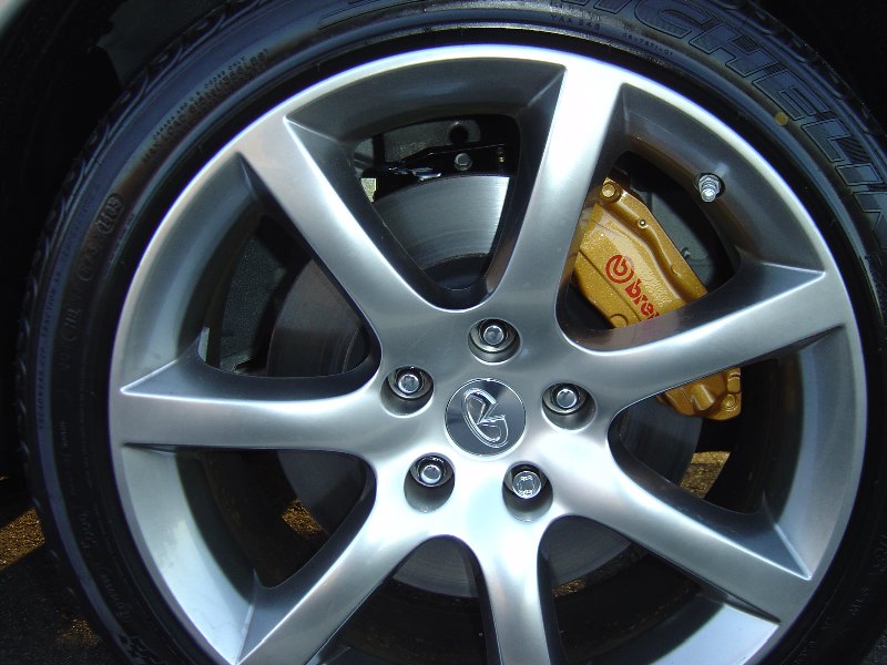

Default Nope - 17" Wheels Do Not clear the Brembos
Originally Posted by lightner22
17s will clear the brembos on a Z...not on a G? You sure?
Sorry for the confusion.
Nope. They will not. I was saying if you did not have to worry about the brakes the 17" would have been a good alternative. 17" with a little more narrow footprint would have made for a better Winter tire, but I am running stock sizes with Pirelli 240 Snowsports. They also cost quite a bit more than some of the choices in 17 inch tires.
Don't waste money buying 17" wheels for a 2004 6 MT - 18" or larger only. I have not seen a 17" wheel that would come close to clearing the Brembos.

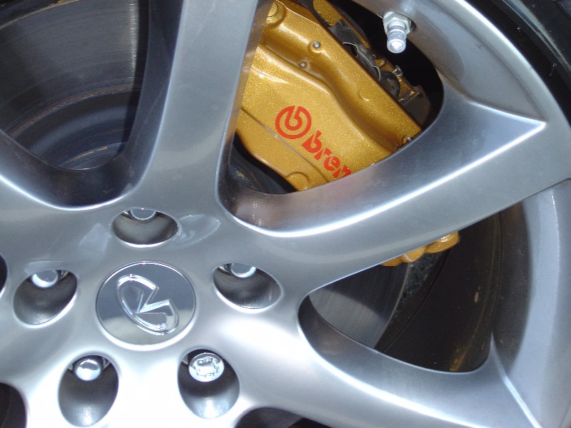

No doubt true. Wish I could have gone narrower and smaller wheel, but I could not fit a 17 inch on my 2004 6MT.

Check out my pics - maybe you have a line on something that will clear, but I did not.
In theory should be the same as my Z; if you know of a wheel that does, I do not. The stock 18" have about 20mm of clearance at the tightest point between the inner rim and caliper, the ASA JH3's a little less, would not fit in 17".
I do not think the G has ever been sold with both the stock 17" rims and Brembos, much like the Track 350Z - 18" rays have been stock wheels. The rotors in front I thought were the same size, too - around 12" in front.
Not much room for downsizing the wheels on mine at least. If you know of a 17" rim that works with the Brembos I'd like to know as I was considering selling the wheels later for something else - I just didn't have a lot of choice at the time and the JH3's are ok but a little heavy (heavier that stock!)
