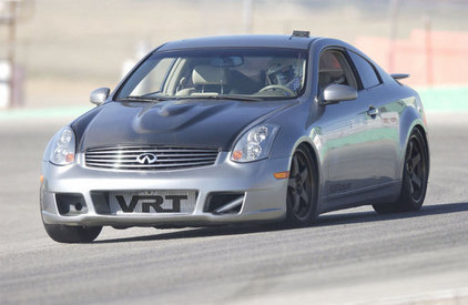

All right all ready............................. For the umpteenth time......Here is some pictures of Me in one of our cars, on Willow Springs Raceway, and some more pics of our tires off our cars. (Note: all on 315/30's on 9.5" and 285/30's on 8.5").
One pic is a 315/30/18 on a 18x9.5" Nismo LMGT4. Almost all of our cars run the 285/30/18 on a 18x8.5" rim up front and a 315/30/18 on 18x9.5" on the rear. In all of our track experience we have found this particular set-up to work out best, for performance, handling and all arround ballance.
These tire combinations are very safe, as we have beaten up on these tires hard on the track, and have daily driven and tracked this tire & wheel combination for alot of miles and going on three years now, "Without any problems at all"
