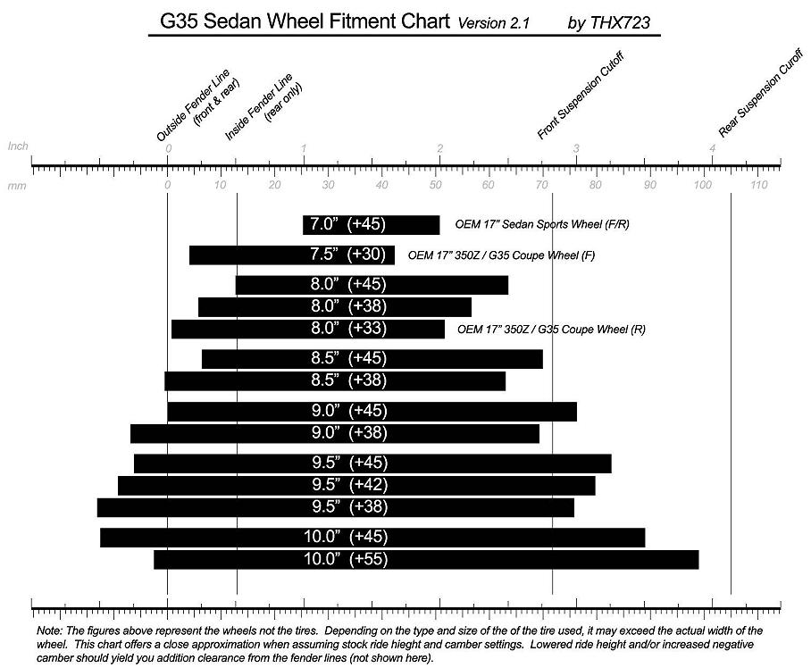

Thank you DMK for your sensible sounding input, it is refreshing. Various references, measurements and calculations are all pointing towards 10" being ok for the wheel but likely not for the tire. 10.5" looks like it will hit the inner wheel well lining. The shock is out of the way.
I *think* 10" might work but I'm going to do more research and careful measurements. There is a terrific G35 Wheel Fitment chart (attached) but even it takes quite a bit of interpretation, especially as it offers fitment dimensions based on the suspension at stock height. I'm adjusting the data to account for my ride height and camber based on the differential between what is stated therein and my actual measurements. I am then applying that differential as an adjustment to the data shown for 10" wheels, then adjusting for a variance in offset. i.e. my offset if I widen my wheels 1.5" to 10" will be +49mm. The offsets illustrated for 10" wheels are +55 and +45.
According to this chart with these adjustments, 10.5" will rub, and 10" will not, with a margin of safety, or rather a gap, of about 12mm (not counting the tire)
The adjustments I made are as follows: Stock 350z track edition front wheel is 8" +30 offset. Adding 1.5" to the inside moves the centerpoint inward by 3/4" or 19.05mm. 30mm+19mm= new offset of 49mm.
The chart shows that a 10" +55mm offset leaves 6mm clearance, while 10" with a +45mm offset leaves 16mm. It follows then that the +49 offset will give 12mm. That's before adjusting for modified ride height (if that is necessary). Based on my 8" +33mm offset street wheels having about 7mm clearance to the outside of the fender, I may need to adjust my wheel position measurement inward by 6mm. That will reduce my clearance on a 10" +49mm wheel from 12mm to 6 mm, unless that adjustment is unnecessary. If the guide was written illustrating the clearance at the closest point throughout the entire range of travel, then no such adjustment is necessary, in which case I have 12mm.
Of course the tire itself, the 285 Hoosier, has a rim width of 10", section width of 11.5" and tread width of 10.9". So theoretically at least the tire will likely intrude 19mm inward from the inner face of the wheel. Oops that gives me a 7mm conflict.
Theoretically then, you are probably right, and it probably won't fit. Problem is that this assessment banks on a lot of accuracy with little tolerance for error, while being 5mm-10mm wrong on something is entirely possible, even likely. That could leave me clear, or in a bad spot.
I think I'll go out and take more measurements, and maybe I need to get a pair of 275 tires.

10" with a 285 on a sedan is pushing it. If it does indeed clear the inside shocks, then you might not be able to put much camber in the rear because it will be a very tight fit. Also, 285 on a 10" rim will sit very flush, might even bulge a bit on the sides. Measure how much space you have between the inside of the current wheel and your shocks.
Hmm. Just went out and reexamined and remeasured both 285 tires and the wheelwell. You are right, it's pushing it. The 10" wheels might fit, but the 285's WON'T.
Shock to Fender measures 11.3". The 285's are 11.5". They aren't going to squeeze in.
Having more carefully measured up everything, I believe I can fit 10" wheels, that the +49 offset will work, and that the biggest tire that will fit, in the Hoosier anyway, is a 275/35/18. With a section width of 10.7" there should be 0.5" to spare, or .25" each side. How much of that goes with a bit of camber is anybody's guess.
The more I think about that though, the more I think that it could easily cause problems anyway, and I would spend $500 widening to invite the problem.
I can fit a 255/40/18 onto the stock 8.5" wheel. It's section is 10.6", giving about .6" to spare overall, or .3" each side. That's probably close enough.
Well, I think I know my choices at this point. 255/40 on the stock 8.5" wheel works and has a section of 10.6" and a tread width of 9.8"
275/35/18 will probably fit if I widen my wheels to 9.5"-10" but might rub. That's set me back over five hundred bucks plus getting used 275's. Probably $750 in all. Tread width would be 1.2" wider than 245's. 255's would give a 0.7 " increase for just the cost of the tires..
The extra 1/2 inch gained with 275's is too expensive to warrant the widened wheels, and the 285's won't fit at all. I guess I should keep an eye out for 255's not. Anybody want to trade 255/40ZR18 for my 285's??
