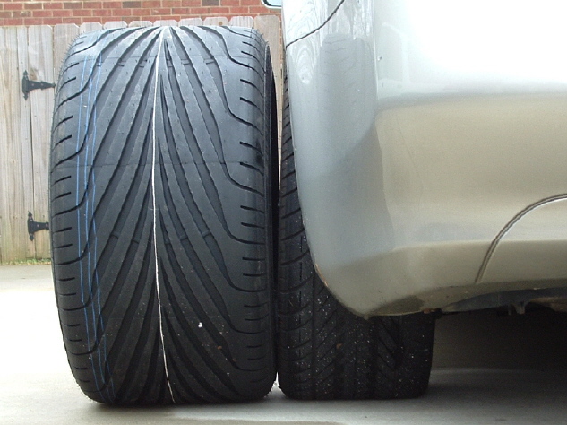

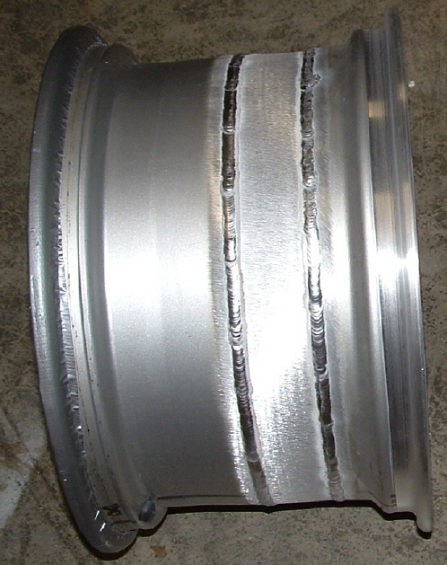

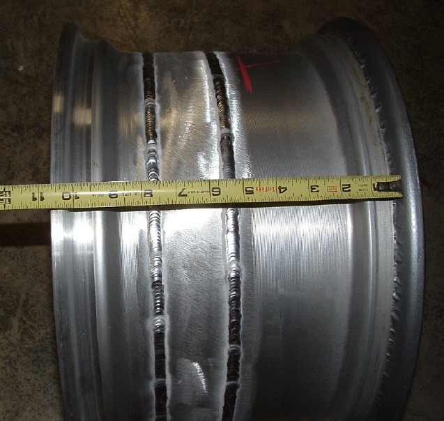

sent out stock 8in rear rims to a place in MI
www.weldcraftwheels.com
$150 plus ~ $20 shipping per wheel
v-grooved welds on both sides of rims. clean beads
the aluminium bands weigh just under 2lbs.
widened rims to: 10 & 3/8 in
I have 25mm H&R spacer on the rear & they gave me about 3in of space to work with.
I wrapped them in Goodyear gsd3's: 315/35 r17
I've always liked to look of the stock rims & wanted to keep the sleeper effect.

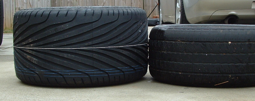

one pics is a comparison of the orig 235's -vs- the new 315's
also the 315 next to the more recent 275's

impressive! Post pictures when you mount them on the car. Might be a close shave:-)

ive seen other posts with someone doing the same thing claiming the welds are as strong as a solid wheel...ill pay a little more for that piece of mind...i paid 950 for a set of enkei rpo 3's brand new in 18x9 and 18x10

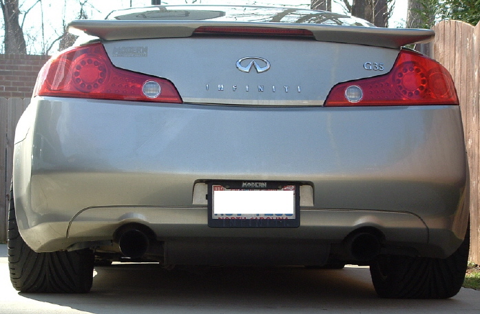

quick rear shot!!
they fit, with about 1/2 in clearance.
more pics to come when it warms up.
now just have to adjust my camber 1 degree or so

WoW. If I saw that from behind. ID shat myself

I was contemplating doing this as well.. I know a lot of people that have gone to weldcraft and their work is pretty good. There really is no safety issue as long as the welds and the add-on metal is sound..

I don't think you guys realize how many wheels are made of two halfs that are welded together or bolted together. Every 2 and 3 piece wheel in the world is put together this way.

the height is pretty close to stock
i'm running 275's up front now.. just moved them from the back to the front!
