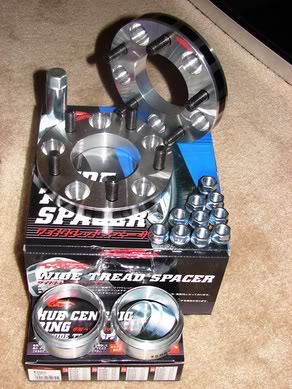

Here is an actual pic from the set I just installed. Great spacers...
installed with G35 rays
installed with Z track rays
AutoRND...
Is that Dana or Josh??? or someone else?

15mm front and 20mm rear seems to be the popular sizing for wheel spacers on the track or g35 wheels
Old Mar 23, 2006 | 01:17 PM
pope's Avatar
pope
Joined: Jul 2005
Posts: 701
From: vegas
+1 i really like this setup. I think the 25mm is just a little too much on the rear. you could prob go 20 on the front if you wanted.

How heavy are these spacers? What material are they? Al 6061 or SS 302?
not too heavy. I couldnt tell you what material though because everything on and in the box is in japanese (with the exception of about 5 words). Maybe Josh can tell you that.
