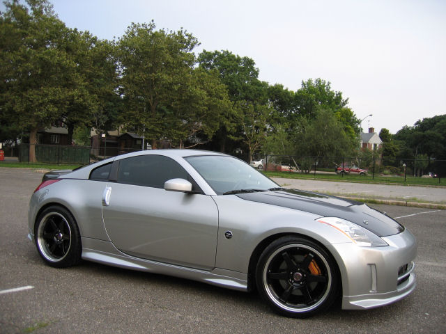

Dave, I'm actually running this exact same setup ... LE37 9.5/10.5 +22 with BF Goodrich KDW 285/35/19 in the rear. When I my ride height was stock....I WAS rubbing during fast cornering or if there was a dip at the intersection.
It's not really rocket science to roll your fenders....mine came out perfect and it was my first time doing it. You just have to make sure the paint is hot to the touch before you get at it.
