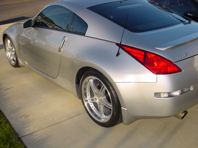

See my 'more bbs info' post below...I have actual pics of the 2 piece version on a silverstone Z!
Pics are up in my other post!
