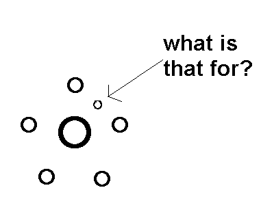

I just purchased some winter rim/tire package and i tried installing it this weekend but i ran into a small problem.. there and extra bolt on the front brake rotor that does not allow my aftermarket rims to be installed... i remember reading here that it was not needed, is this true?... if so, how did you remove the bolt?

search and you will be rewarded...
it's not needed...take it out and they'll go on...

Q. I can't get my new rims to fit on the front. There's a little bolt there! What can I do??
A. That little bolt is there so your tire guys don't put your stock rear rims on the front by mistake. To install aftermarket rims, just get a 10mm wrench & unbolt it. Problem fixed!
