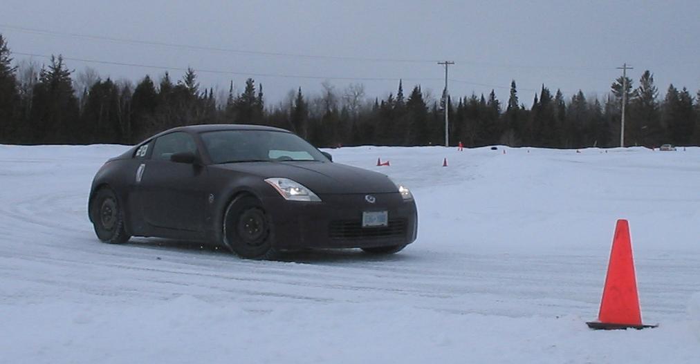

I'm running 215/65/16 Blizzaks on steel wheels all round.
Nice and narrow to cut through the snow and slush.
I've been running non stagger for 3 years now (summer, winter, Solo2) and there's zero issues, VDC works as usual.

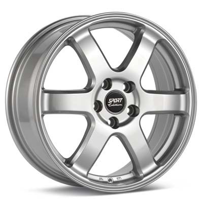

I called tirerack and got a set from them. I already went through a test fit, and they work just fine.
Front:
17x7 Sport Edition E2
225/50/17 Bridgestone Blizzak LM-22
Rear:
235/50/17 Bridgestone Blizzak LM-22
