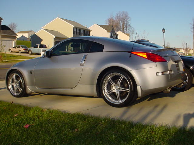

You are in luck. A lot of people have gone before you and purchased wheels so you'll get better numbers to work with. I agree that the search for my thread has all the info you'll need. Couple of comments though. I got 8.5 front and 10 rear. Offset is 37 front and 41 rear. They are a little tucked but it doesn't bother me at all. Never used the spacers I purchased. Regardless you should see if you can get the offset at around 30-33 front and 33-37 rear. That should be about perfect for the SSR's. It will enable you to drop it if you want later on. Here's a pic to tease you. You see the rest in that thread.

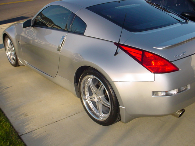

One more because I'm a good guy....By the way tires are 245/35 and 275/35....

Look Great!
By the way what's the bolt pattern or bolt code?

those are one of my favorites as well, good choice.

Hey, nice car! Just one question... is your car dropped?
