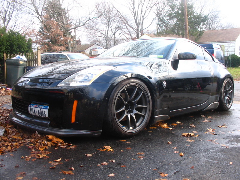

Here's a pic of the Works 18x9.5, +12 all around on some member's ride.. still trying to decide what finish, though:
Wow that car looks really good with the works.

Won't a +20 give it more of a "concaved" look? Thanks.
I was under the impression that lower offsets meant more concave, so +12 would be more concave than +20.
Old Feb 21, 2007 | 09:46 AM
Nihilation's Avatar
Nihilation
Joined: Sep 2004
Posts: 1,044
From: Ashburn, VA
Correct.
