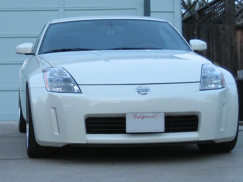

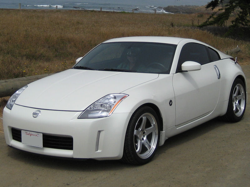

I think the Goodyear GS3s come in the 275/35~40 sizes. There are about a dozen different tires in these sizes in a summer category, most are not cheep. Thing is, the Kuhmos are so much better than stock that it was still a vast improvement.
Let me know if these pics help. The back could easily take a 10mm with these tires without any body mods, and I may do that down the road but I like the front just where they are.
Chris
