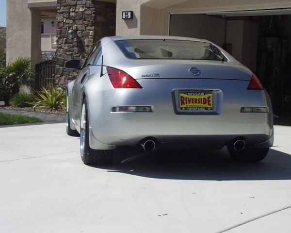

mine sits pretty close, that is why I did so much research about the offsets before I bought
Front 19X8" +18mm
Rear 19X10" +29mm
here is a pic

oops, here is a better one
Im in the same boat that you were in. Very nice pics, are you running 275 tires in the rear? Thanks for the offset info.
yep, 275
