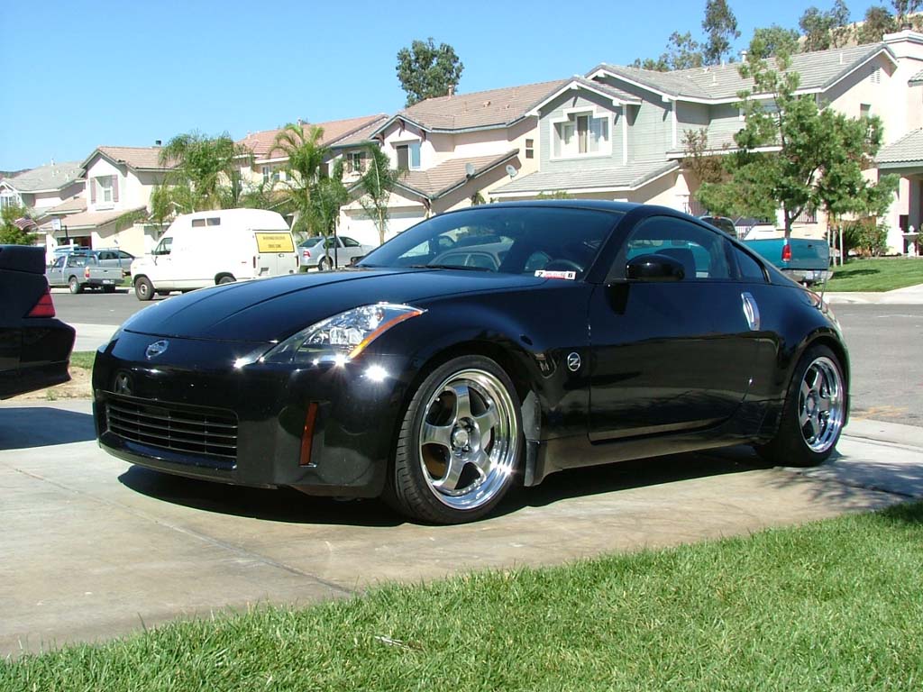

Haha, I'm not trying to "buy coolness" . I just know what I like. Work Wheels on a blkZ are probably the best looking I've seen on a Z (can't post pic bc file too large), besides the chromed out 18" SSR Professor SP1's (below). And at 1/2 the cost!
