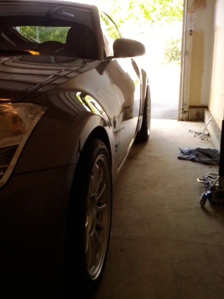

After a long wait I finally got in my Type-Fs.
I am a littler concerned about the front. It looks like the wheel/tire is poking out almost a 1/2 inch from the top of the fender. I havn't driven it yet but I'm assuming the fronts poking out this much will rub. My guess is I'll need around -2 degrees of camber in the front to make this work. Thoughts?
I know there are some guys in here running the 10.5 +15 up front. A 9.5 +12 wheel should sit about 10mm deeper in the wheel well then the 10.5 +15. So maybe I shouldn't be concerned at all.
I have KW v2's and SPL front and rear arms waiting to get installed too!
Specs:
18x9.5 +12 265/35
18x10.5 +15 285/35
Attached pic is obviously at stock height.

Once you get your coilovers and camber parts installed you will probably be fine. How low you go will determine how much camber you'll need to not rub. Those are some beefy tires so you may not be able to slam it. However, because of how beefy they are it doesn't look like you're trying to be "low n slow".

Hey Mike...you'll be just fine after you lower the car and add a little camber. I have a 10.5 front at +15 and i'm running -2.7 degrees of camber

you'll be fine. a lot of guy are running those specs in front.

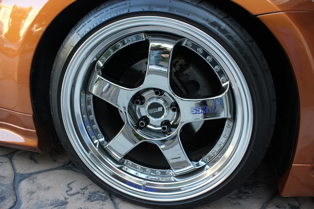

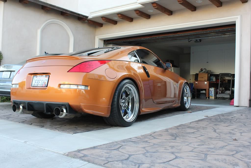

Here are a few pics of FRESHZ's 19" SP1's in SBC
