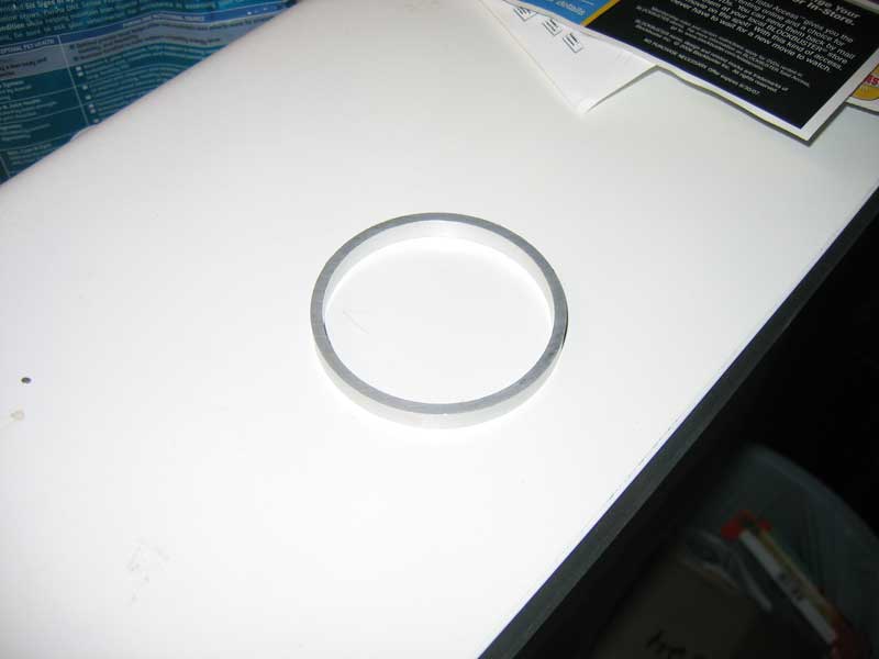

I just got some new volk wheels and they came with 4 of these small rings, which I think are known as "hub rings". They fit on the hub and inside the wheel, so I'm wondering what they do? Should I be using them? My current volks don't have them.. Here's a picture of one of the rings:

Yes you need to use them.

The ones in the photo above that came with my wheels say this on the outside:
73.1φ X 66.1φ
I'm not sure what those φ symbols are.

yeah.. those rings are for centering your wheels... you HAVE to use them

Aluminum is a lot better than plastic. Correct size hubcentric rings will ensure a vibration free ride.

put them on the rotor . they won't go all the way in , but when you put your wheels on and bolt wheels down they will go in .
