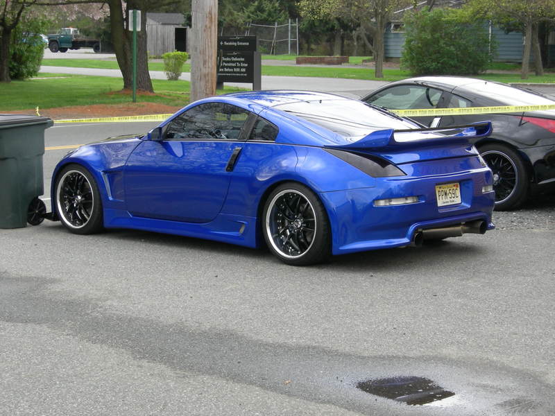

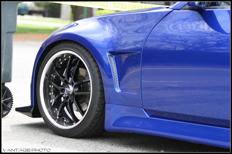

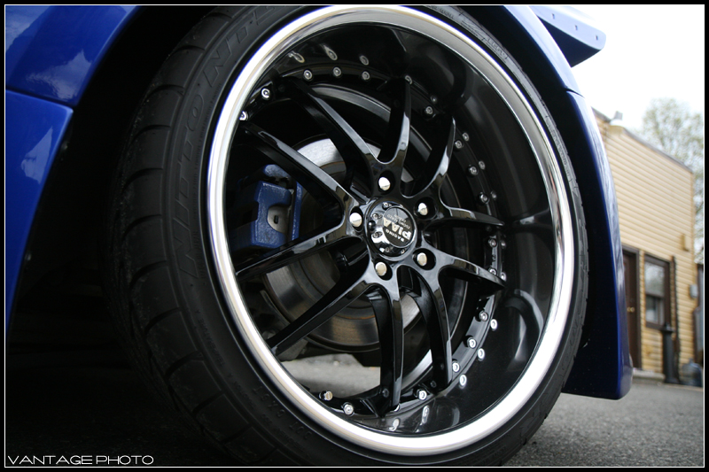

275/30-19 in the rear and 235/35-19 up front....they look good...lowered with eibachs too!
Attached Thumbnails Anybody running 30 series profiles on 19"s?-mrcdynoday001.jpg   Anybody running 30 series profiles on 19"s?-bbq17.jpg   Anybody running 30 series profiles on 19"s?-bbq6.jpg
