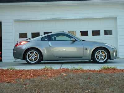

enkei

2003z, do you know whose car that is with the RPO2s? I've about decided on them but the available offsets look a little high. I would love to have some feedback from someone who has already put them on a 350z.
Thanks,
Eric.

It's my car. I am running race rubber on them. I got 17x9 +35 all around and the offset is not a problem. I had 18x8 +35 rpm2s originally on the front and they sat too far in, but in a 9" rim, a +35 is fine.

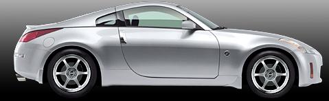

The SSR Competition is a lightweight forged wheel. I had these in 17x8" on my Acura CL. At that size they weighed in at 14 lbs. I bought mine for $360 through a local speed shop, I think larger sizes that fit the Z can be bought for around $500. Don't know how that compares to TE37 pricing, though.
