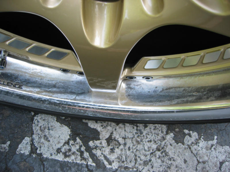

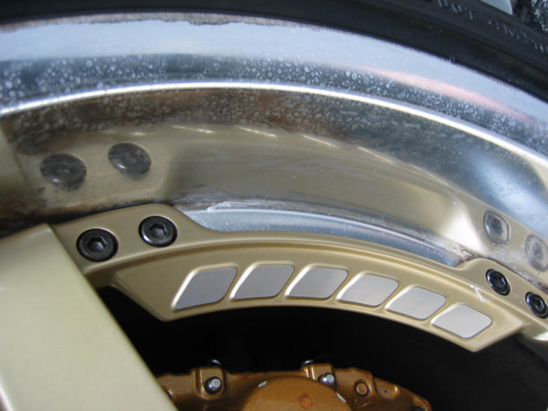

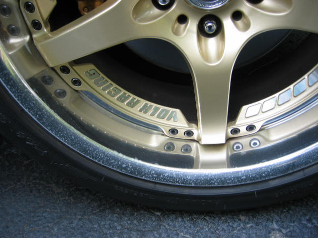

So I got my bumper fixed and repainted because of a small fenderbender I got into, and everything looks good EXCEPT MY VOLK SF CHALLENGES NOW ALL LOOK TO HAVE THE CLEARCOAT COMPLETELY RUINED WITH WHAT LOOKS AS WATERSPOTS ALL OVER! I tried multiple things to clean it up, from claybar to vinegar and water mix, nothing works. They told me they would pay for them to get fixed at a wheel shop but I dont know if local wheel shops could re clearcoat a polished lip after refinishing them? check out the pictures...

Cleaned them with wheel cleaner, wheel cleaner = acid on Volks!
Old Aug 8, 2007 | 02:58 PM
davidv's Avatar
davidv
Posts: 42,753
From: Tucson, AZ
Thanks for the photos.
Looks like chemical etching. There is no home remedy. You would think that body shops would learn to cover the wheels before washing.

1. You'd have to have confidence in the chrome shop to take apart the wheel so they can just chrome the lip/outer barrel. I'd also contact a Volk distributor to see if the bolts can be reused or not; usually the can not. If you are going to sell the car anyway, I'd opt to have the body shop pay for the refinish (including curbing) of the wheel. That means taking apart the wheel (see point 1) and refinishing through the clearcoat portion (I don't think they are anodized, but could be wrong), then polishing and clearcoating them.
I know of one instance in particular with a local friend who experienced damage to one of his Volk wheels from a wheel cleaner. I don't recall the brand of wheel cleaner, but after some hassle, they (the company that produces the wheel cleaner) replaced the Volk wheel for him.
The honest reality is that your wheels will never be THE SAME again. I'd suggest your body shop keep your wheels and cut you a check for FULL REPLACEMENT of them, circa $2400. They should know better, and it's their responsibility to replace your damaged product with the exact product. This is why I always put on stockers before my car is even serviced, let alone in paint. From there, you can do what you wish with the $$.
