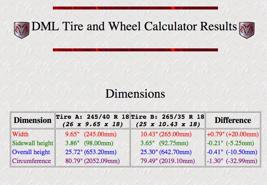

Originally Posted by wayneside
i'm getting some tires for a friend...same size wheel and doing 245/40/18 fronts and 265/35/18 rears...using the new Dunlop Direzza Z1's!
if you want to max out the tire...go with 265/35/18 front and 285/35/18 rear like terrasmak said.
The front tires are 10.5mm taller than the rear. Are you sure you want to do this?
