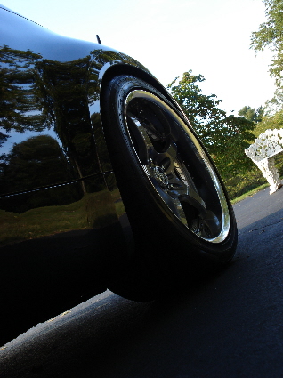

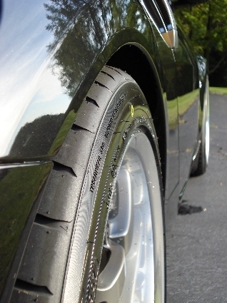

here are some pictures to help illustrate:

I don't get it...How can you rub with that setup (assuming you have rolled your fenders)
Example: I'm not rubbing with the more aggressive setup below
I'm dropped with Tokico D-Spec Full Susp (-1.25")
Work Meister S1 19x11 (rear +29) with Toyo T1R 285/35/19
My setup is like your set up (.5" wider = 12.7mm divided by two [ because the wheels are wider evenly on both sides making my offset similar - if not more aggressive than your 19x10.5 +23)
We use the same tire brand and size so why would you rub when I don't.
My guess is that your fenders aren't rolled fully, can you take pics of the rolled fenders? Honeslt you should have plenty of clearance. I have about 17-20mm left so I'm getting a more aggressive offset coming in soon 19x11 +17 w/ 285

Yea i dont understand why i'm getting wheel rub in the first place. And the shop mechanic was really nervous about rolling the fenders any further, he said he rolled them about 45 degrees inward. I'll take some pics this afternoon of the inside of the fender.
thanks again guys and btw Alvinhuyn and Tomci, what camber are you guys running in the rear? is it passed -2.0 degrees?
45 degrees is not fully rolled. The inner side of the fender should be straight up, parallel to the outside part of the fender, and almost touching each other. If that mechanic is not using a fender roller, you're asking for trouble. Looks like they've never rolled a fender before.
Old Oct 2, 2007 | 10:46 AM
redlude97's Avatar
redlude97
Joined: Feb 2006
Posts: 2,754
From: Seattle/Portland
What he said, 45 degress isn't even a half roll, that barely gave you anymore clearance. Go get a real fender roll, plenty of people have gone farther without damaging the paint
Old Oct 3, 2007 | 01:55 PM
Alberto's Avatar
Alberto
Cranky FI Owner
Posts: 34,715
From: DMV
+1 I roll fenders and thats a half a$$ job. Ive done many set-ups with more aggressive offsets and wider tires with BETTER (more +) camber with no rubbing issues. I run 285/35/19 lowered more than you with -1 camber and dont come close to rubbing!
