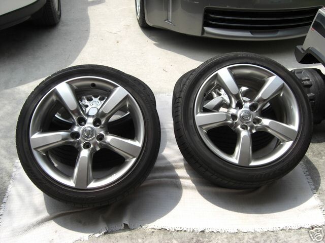

I found a set of take-off 18"s with tires (500 miles) and want to install them on my 2005 Enthusiast. Will the sensors, and everything work out?
My stock 17"s are boring and I like the new five spoke better. The color is a little different as well.
Thanks in advance...

does your current car have the sensor capability? you cant just get the sensors from another car and your car automatically work.
if your car does have the TPS sensor capability then you need to get the sensors out of your wheels and install them on these new wheels. BOTH WONT WORK. only one set of wheels

If I have the dealer install the wheels can they re-program the TPS for the new 07 wheels without having to remove 8 tires and do a sensor swap?

07 sensors are different and will NOT work on pre 2007 cars
