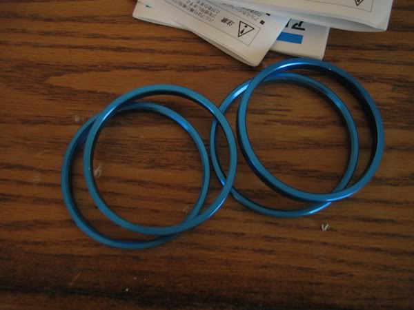

My wheels came with these:
Should I have installed them?? Or are they only for use with spacers?

Looks like aluminum hubcentric rings. I put them on with my wheels. I don't use spacers though.

hub rings are for wheels that arent hubcentric. most aftermarket wheels arent hubcentric to the z..those are there to close the gap between the hub and the wheels bore, eliminating some vibrations

Thanks for the input guys. I will go ahead and install whenever I have a free minute.
