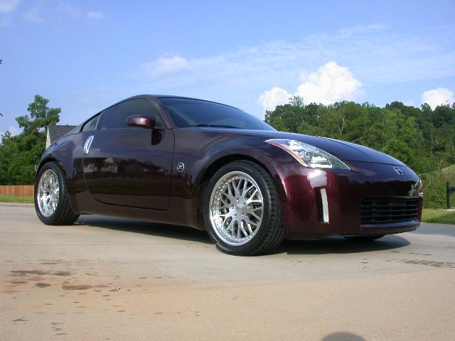

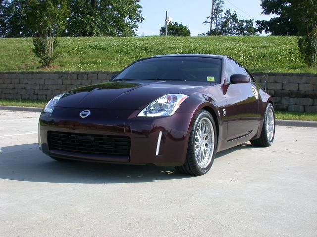

Finally, after many months of waiting, my iForged Senekas have arrived!!!
I have also tinted my windows since my last pics. Below are a few pics of the new look followed by my review of the iForged wheels and buying experience.
First a nice side shot...
For those curious or who may yet order iForgeds, here is my detailed review of the wheels and my experience. I apologize in advance for I'm sure this will be long.

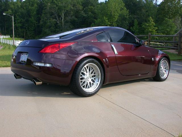

Okay... I'd be lying if I said I didn't have an issue here. I have some minor wheel rub (under very hard cornering or over large road bumps), but the jury is still out on whether this is an iForged issue or an Andy issue.
Basically, it's like this, my plans for the wheels changed between placing the iForged order and placing the order for the S-03s. The size of S-03 I ordered really calls for a 9.5" wheel... I ordered 9" wheels. More importantly, the offsets probably were not measured with a 275 width tire in mind. Consequently, I have some minor wheel rub
The solution... well, the first thing I'm going to do is order some 265/35/18 S-03s for the rear. This is a slightly narrower tire and will reduce the sidewall height by 2/3rds of inch (17mm). My bet is that this will fix my rubbing issue and I will still be happy. If this does not fix the rubbing, then it becomes an iForged issue and I will be taking it up with Vince later this week.
The short of all above is that the fronts and backs are very close to inline with the edge of the wheel well and give the wells a very full look that I happen to like.

The Specs
- Wheels - iForged Senekas - 18 x 8 fronts, 18 x 9 rears
- Tires - Potenza S-03s - 245/40/18 fronts, 275/40/18 rears (see notes below)

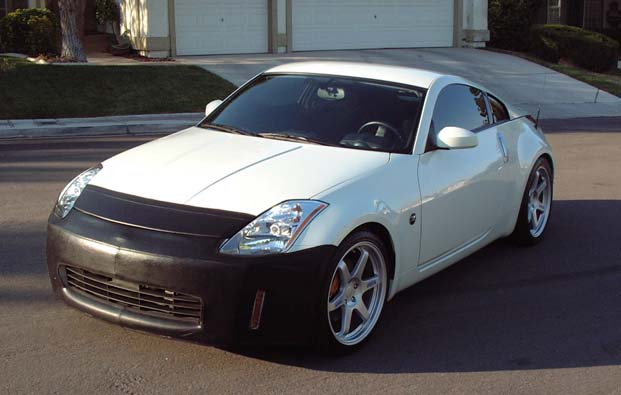

Your wheels look awesome with the Brickyard!
I like the fact that you're not running a spoiler and those gawdawful spashguards.....both of those add-ons spoil the clean lines of the original, pure design, IMHO. I guess we have similar tastes where those things are concerned.

EDIT: I just looked at your pics again. Jeezus! What offset did you spec in the rear? A +12?!?
droideka...
I agree that 265/35 rear and 245/40 front is not optimal, but the wheel height is less than 1/4" greater on the front tire. Would this really have any great adverse affect on driving?
To answer your offset question, I did not spec them. They were supposed to be set correctly for me
One reason for this is because I've never had to deal with setting an offset before... always bought wheels made for a specific car model in the past. Are you saying a +33 would have set the wheel under the wheelwell further? I don't know the exact offset now, but I will find out tomorrow.
The fact of the matter right now is the 275/40/18s are rubbing and I cannot leave them on. Since I only had them mounted Friday, I have not had much time to address the issue. I was hoping that if I could go with 265/35/18s, I could avoid having to return the wheels since, I suspect, that would mean waiting another 3 months to get different offsets if that is the problem.
One reason for this is because I've never had to deal with setting an offset before... always bought wheels made for a specific car model in the past. Are you saying a +33 would have set the wheel under the wheelwell further? I don't know the exact offset now, but I will find out tomorrow.The fact of the matter right now is the 275/40/18s are rubbing and I cannot leave them on. Since I only had them mounted Friday, I have not had much time to address the issue. I was hoping that if I could go with 265/35/18s, I could avoid having to return the wheels since, I suspect, that would mean waiting another 3 months to get different offsets if that is the problem.

I'm not an offset guru by any means, but take this into consideration. The stock, 8" 18s are +30. The stock rear RAYS 8.5" 18s are +33. It would make sense that the next step up to a 9" rim would also be a higher offset at say around +35 to keep everything in sync. Lots of folks around here run +22 to +27 on the rears no problem, but it looks like you got talked into something way off from the norm. I'm thinking that's a +12 or +15 from the looks of it. The numbers don't make sense, do they? I still don't know why, but the lower the number, the further the entire wheel sticks out from the hub. It has to do with the depth of the center of the wheel where it actually attaches to the hub. Low numbers means more material, high numbers means less material.
Sure, VQ... I actually have some higher resolution shots if you want me to email them directly to you. Have PMs turned off because the firewall at work block them and I never know where I'll be checking the site from.
Thanks to everyone for the information on offsets. I did think they sat out a bit much, but didn't worry too much until I experienced the rubbing. I am calling iForged today for more spec info. I'm hoping something can be arranged. I'd hate to have to the credit card dance on them, but will if necessary.
The wheel offsets are in spec. They are +18 for a 9, which translates to a +30 on a 10 in proportion to the outer fender. The reason they are rubbing is because when Andy placed the order, he told me he was going to use stock tires. Also on a 275 it is recommended to go with a 10, so on a 9 wide the tire will overhang over and bubble up. On a 10 the tire is stretched a little. If Andy still has problems with it, we will make the wheel a 10.0 at no extra charge to solve the tire problem

Yes. That's a bad thing and will probably f**k with your VDC. The smaller rears rotate at 820 RPM vs. 814 RPM for the fronts. The tire speed sensors are not going to like that. I'm taking this data right from the S-03 data sheets on the Bridgestone site.

You definitely don't want the shorter tires on back. Have Vince remake them like he has offered. This is what all 4 tires the same size looks like, with the rears smaller it will look like the rear end is sagging.
