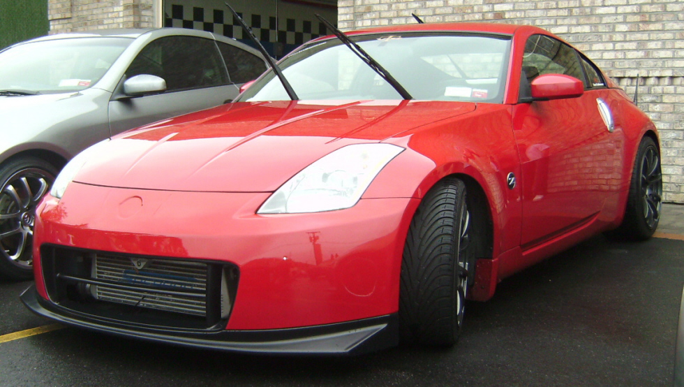

More of same wheels on same car advan RS 18X10 +15 all corners
Attached Thumbnails suggestions: 18x10.5 + with low offsets (+12 or so)-alex1.jpg

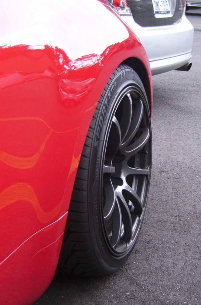

two more.
Click on pix to show larger size
Attached Thumbnails suggestions: 18x10.5 + with low offsets (+12 or so)-alex2.jpg

Originally Posted by str8dum1
ya thats the problem then. the rears on that red car looks waay more concave then yours. I thought the offset moved the face of the wheel. less offset meant more space between the lip and the mounting bolts. But you say that Advan keeps the face in the same spot and just builds up material (10mm in the instance) behind the face?
FWIW, the red Z only had to roll his rear fenders to fit those 10.5 +15 front and back.
Interesting.
Yes... the mounting pad thickness changes. The face doesn not change.
The red car likely has 275 tires on the back and not 295 tires. I have 295.
The wheel size is 10. Not 10.5
The poster above states these wheels are 18. And by the look of it his tires are 275.
JET

Actually, the face does change. You can compare a TE37 19x10.5 +22 and a 19x10.5 +12 and you can see the face has a bigger dish and is slightly more concave. The pad thickness doesn't have anything to do with offset. You can still have a low offset wheel but in a high pad version, again, just like a TE37 19x10.5 +12; low offset wheel but has high pad clearance.
But not for all rims... I know my SF winnings spoke cross-section is similar front and rear, but the mounting "pad" or a cross-section of the rear casting pad is much thicker. Yes, its a two-piece and they play around with the forged spinning or ring "lip" depths too. And as you stated, there is also a high/mid/low pad version of the spoke casting.
Its amazing how many combinations there are just for my wheel type, a lot of R&D and money spent on manufacturing!
I want to run 305/30/19 PS2s in the spring. And I actually wish I had a +40 offset in the rear...

I didn't see your reference specifically about the ADVAN RS. On ADVAN wheels, you're right, they only offer 2 different face type, regular and GTR. The GTR face will have concavity where as in the regular will not so the lower offset wheel will not have anymore concavity than the higher offset wheel if they both have the GTR face. You're right, Larry!
