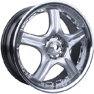

Great Thank you for your input, What do you think of ICON W-65, are they good wheels?

What size is best. I guess I need to know the off set??
19x7.5" Hyper Silver with Machined Lip, 4x100/4x4.5 B.C., +45mm
19x7.5" Hyper Silver with Machined Lip, 5x100/5x4.5 B.C., +45mm
19x7.5" Hyper Silver with Machined Lip, 5x112/5x120 B.C., +45mm
Thank you again!

the rims that you picked are copy-cats of the volks. i do not think that the offset of those rims will properly fit a 350z and you might have to use spacers. also the bolt pattern is 5x114.3. those are nice rims you picked, but if you want higher quality and a perfect fit for the z, go with volks

On the Icon's, is it bad to use spacers also what do you mean they would not fit properly??
