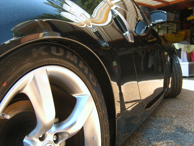

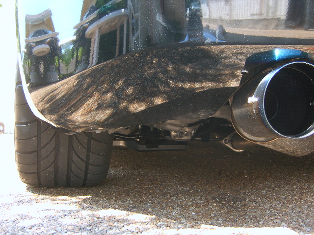

I posted soooo many times it's not even funny..
search next time...
Attached Thumbnails Anyone with 265 or 275 rear, but OEM 18s?-sa503976.jpg   Anyone with 265 or 275 rear, but OEM 18s?-sa503971.jpg
search next time...
Sorry... I don't see anything... I guess I missed your point.
Your pics show very little if anything.
--Spike

Originally Posted by Arnold K.
In the pic showing what a bulge would look like. It shows a ( shape, right? I was just describing what the shape is: a bulge that curves at both top and bottom unlike the other two shapes in the pic.
Hope that's clear. If not, it's okay. :P
rkd: Umm, you try searching for 265 or 275 in the search field. Thanks.
I have no idea why he (rdk350z) suggests searching since his pictures and information are worthless to this discussion. I suspect he is simply parroting a robotic command.
His (rdk350z) first picture is taken close to the subject with the lens set to wide-angle. That picture with its poor composure and obvious distortion is pretty much worthless. The second picture shows the tire tread, and again is not useful to our discussion.
--Spike
