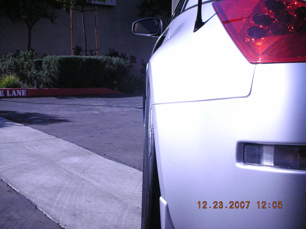

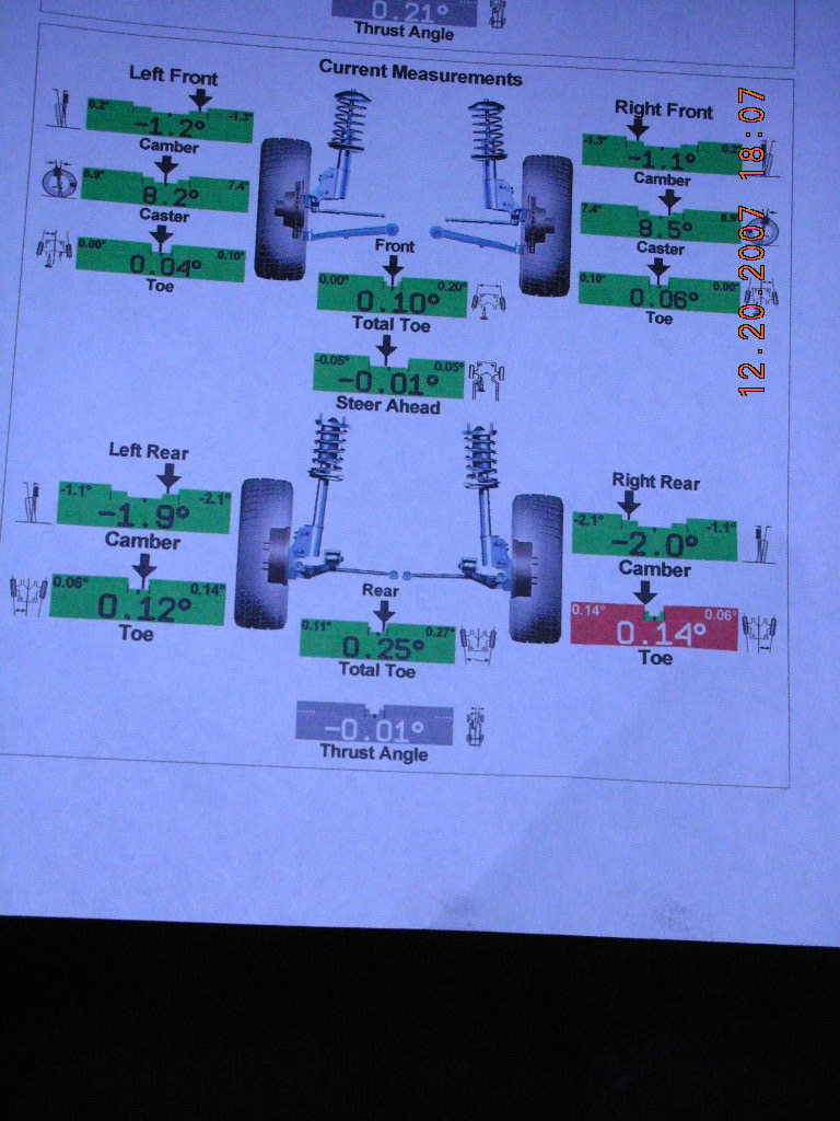

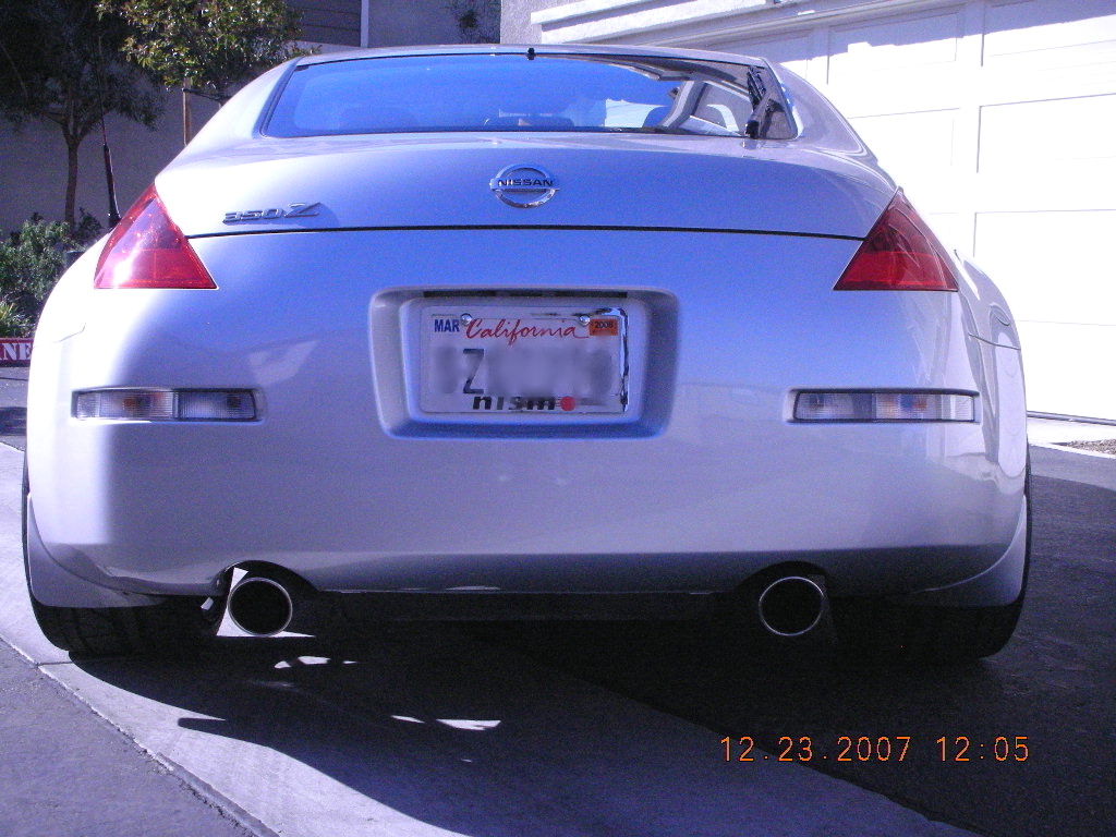

RE30 19x11 +25 OFF. 285/35/19 NITTO INVO, Fenders cut
