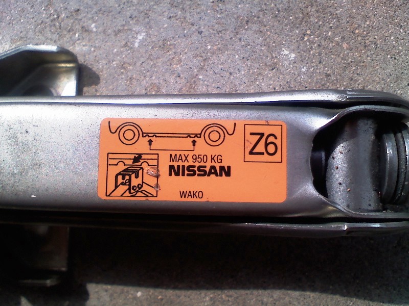

this is for the next guy that might ask the question..

I don't blame you, I came across this problem too about a year ago when I was installing my suspension. I ended up figuiring it out after five minutes of inspecting the underbody of the car. Great diagram, I'm glad I was able to figure it out without any damage to my car.

I think it's pretty common for all modern cars to have these reinforced areas on the side frame rails for using the OEM scissor type jack.
Originally Posted by nismo_nate
i went to a tire shop for to patch my tire which was losing air very very slowly.. then the guy (certainly looked like he was working under the table) went to jack my car up.. he didn't know where to line up the jack.. i have my veilside sideskirt wings he decided to go in the area where the wings bolts up to.. long story short.. my rear left wing is not even touching the lower panel..and is loose.. and i'm just to lazy to take it off.. lol..
i should print out the diagram for that dude so the next 350z owner won't experience this. lol
I also have Veilside side wings. The mounting flange for the rear pieces sit above the factory side rail jacking locations, so the jack will crack the mounting flange when the car's weight is applied to it. The way I got around this was to have a little piece of square key stock (steel) welded into the groove in the scissor jack, so that the jack doesn't slip completely over the rail and therefore does not contact the underwing mounting flange. The downside is that all of the load is taken on the edge of the side rail, which causes it to deflect bit by bit every time I have to jack up the rear. I'm actually thinking of buying a floor jack so I can jack from the rear differential to avoid this problem in the future.
