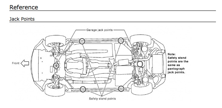

So i got a new set of rims today and decided to install them. When i went under the car to see where the jack points are i didn't see any. So i just picked a spot that looked strong enough and used that. After I installed the first wheel and lowered the car, i noticed that the piece of metal that it pushed up on was bent. Although no one will ever see it, it does bother me quite a bit. I have a 2005. Is it like this for everyone, meaning, its not clear where you should be jacking the car up from? Thanks.

There are 2 jack points for the car. One under the engine, and the other is the rear differential housing. There are a few other safe places where the sub frames meet the unibody, but that's for later Danielson! Don't forget to use safety stands. Locations in photo.
Jack Points

Here's the diagram... hope this helps!

the owners manual should have the points but i mean when worse comes to worse the best is under the motor for the front and the rear diff housing for the rear

Thats exactly where I raised it on, and it still got bent. ugly. And thanks for posting this.
