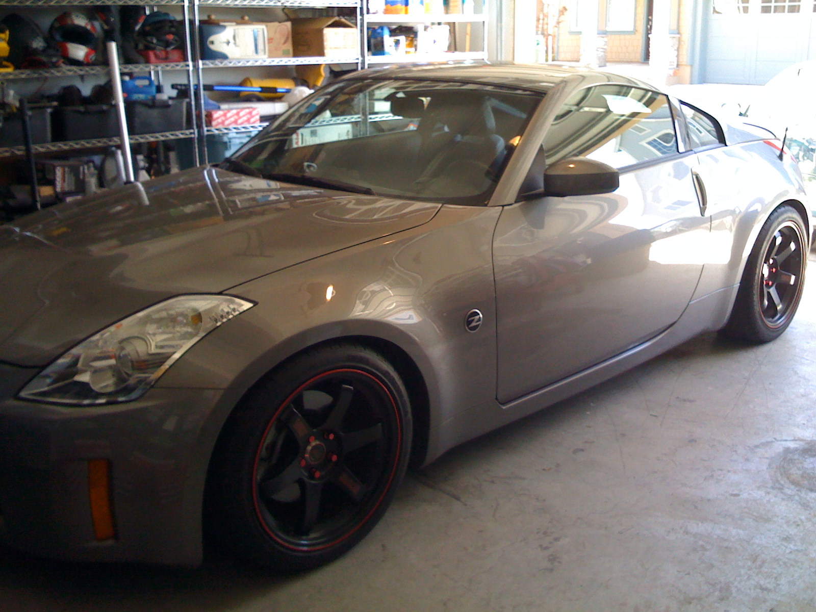

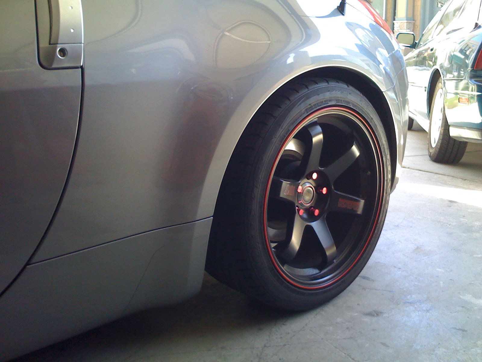

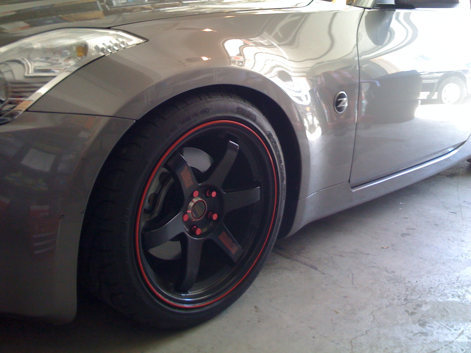

TE37 18in 9.5/10.5 +22 all around with 265/35/18 front and 285/35/18 rear dropped Front 1in/Rear 1.2in will not rub and will not require fender rolling. I doubt a 285/40/18 Rear will rub either with +22. I think +22 all around is the best offset, but that's me.
Go with the 9.5/10.5 setup, you'll be happy you did. It'll give you a nicer aggressive stance and more grip when cornering.
Go with the 8.5/9.5 if you want to save gas.
