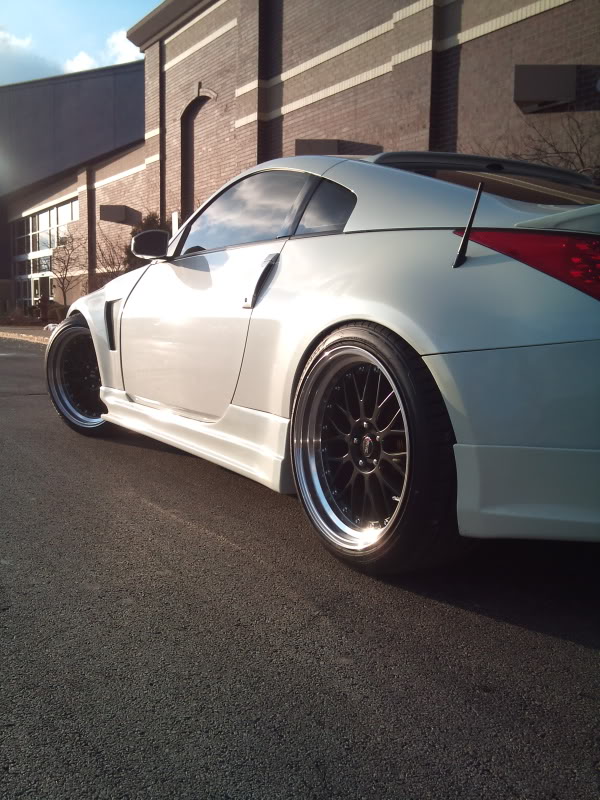

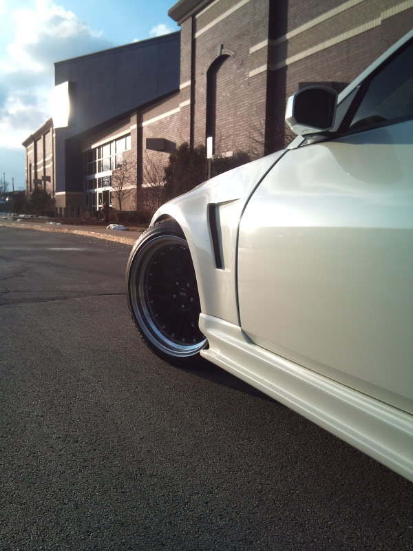

BigMo350z's Avatar
BigMo350z
iTrader: (21)
Joined: Dec 2008
Posts: 359
From: West Suburbs (Chicago)
20x10.5 all around
offset front + 23mm
offset rear + 0 mm
275/35/20
front camber -1.3
rear camber -2.6
Old Feb 26, 2011 | 09:24 PM
