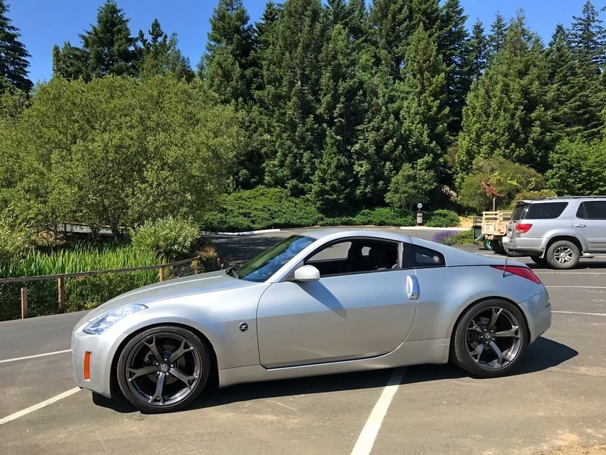

Trust me, they fit.
Nissan LMGT5 (Z34 Nismo, 19x9.5 +40, effective +20 (spaced) F and 19x10.5 +23 R - 255 and 285/35 respective. Given this, most any Z34 wheels will fit incl. Sport 19x9/10 so long as front is spaced properly.
Fronts REQUIRE 20-25mm spacers to give an effective offset of +20, +15, respective.

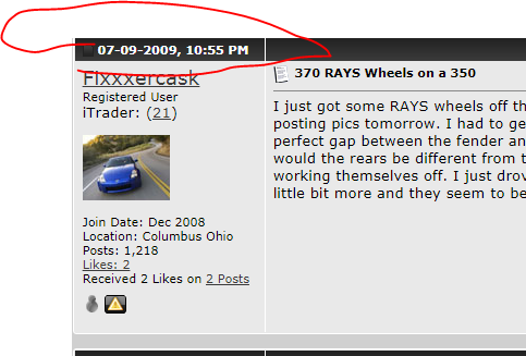

Originally Posted by kris z
you are using to wrong lugs dude... thay need to be flate with a washer...
that post is from 09 and he hasnt logged in for a couple years........ good job
