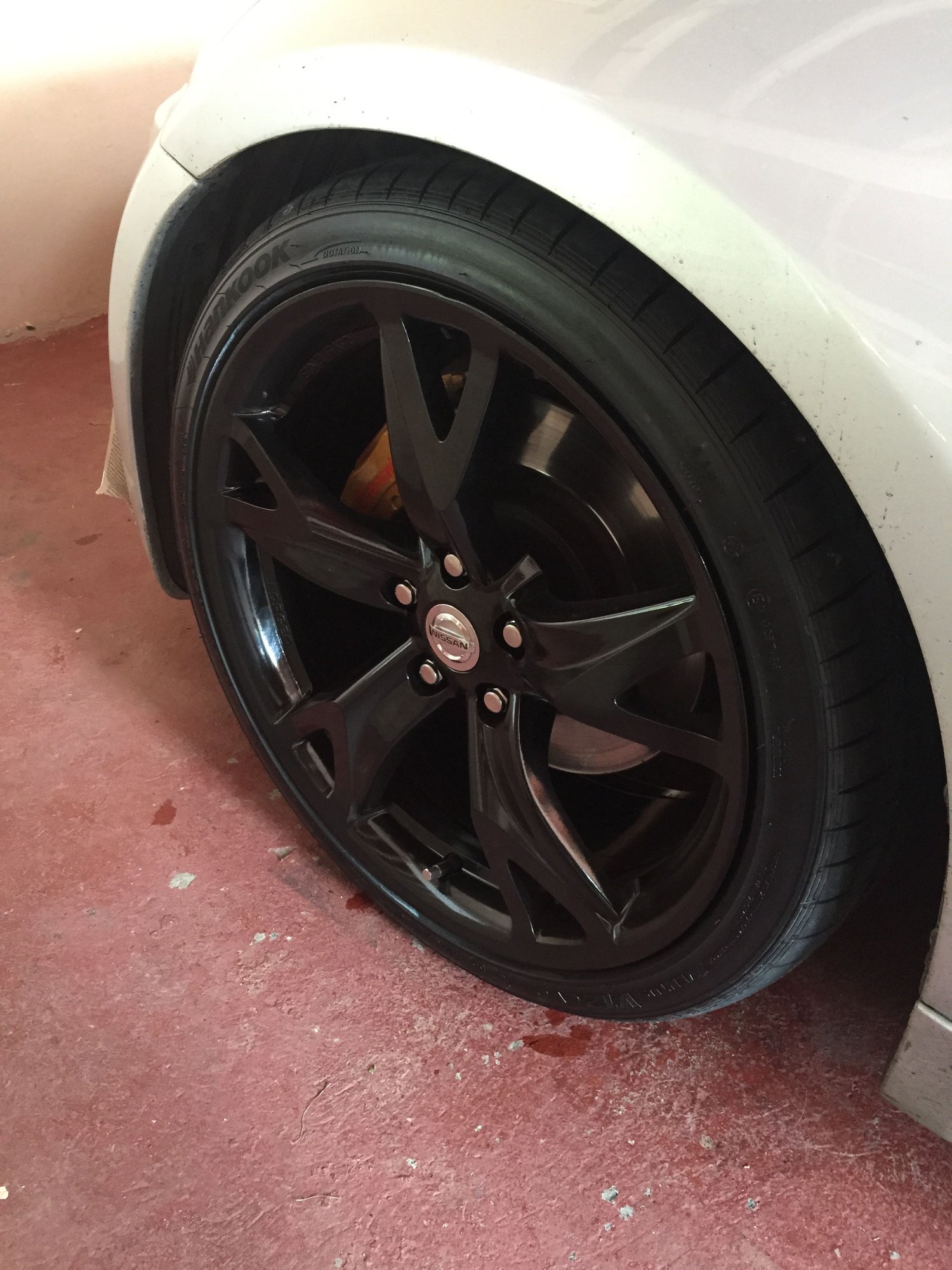

With no information thus far on fitment of the Rays wheels from the 2015 NISMO 370Z on our 350Zs, I'll consider myself a pioneer and demand that each of you reward me with an oatmeal cookie.
The 2015 NISMO Rays wheels, as most know, are 19 X 9.5 in the front and 19 X 10.5 in the rear and are equipped with 245/40/19 and 285/35/19 tires respectively. I can confirm that they have +40 mm and +27 mm offsets front and rear.
My '05 is equipped with Brembos. Fitment of the rear wheels was issue-less, but the front wheels (though they cleared the Brembos) required 5mm spacers as they rubbed against the suspension knuckles. No hub-centric rings were needed, as the bore size of our cars is the same as the 370Z's - 66 mm. I used the 370Z's lug nuts. I don't know whether or not the 350Z's lug nuts would have worked; I didn't try.
Here are some pictures I quickly took after they were installed. The car is on factory suspension, and I see no need to lower it (famous last words). I'd be happy to provide more pictures from specific angles; just let me know.
