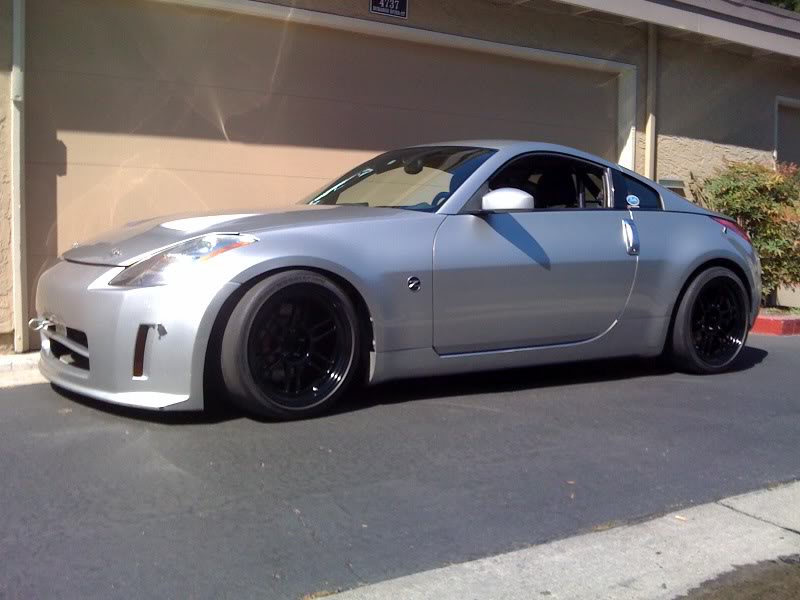

One of my 3 (I have a problem) sets of black Enkei RPF1 wheels. These ones are the 18x10.5 +15 all around and have 285/30/18 Hoosier R6 tires on them.
The front is a perfect fit with very little additional clearance. The inside has a few, maybe 5, millimeters left. The outside just tucks under the lip. No fender modifications have been done so far; I'm at 3.2* negative camber in the front.
The rear is pretty aggressive, though I think that the suspension will keep it from rubbing especially with the short 285/30 tire, I'm going to roll the lip anyway. It has not rubbed (yet?) from my driving around town. The rear is at 2.5* negative camber.

^I love black RPF1's!!

+1, that is a nice setup!

Can we see more angles of this?! I like your setup, looks good!

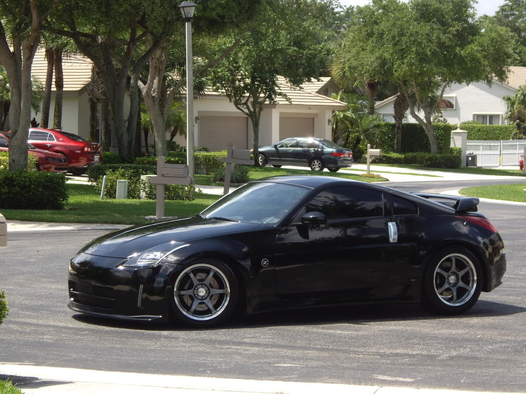

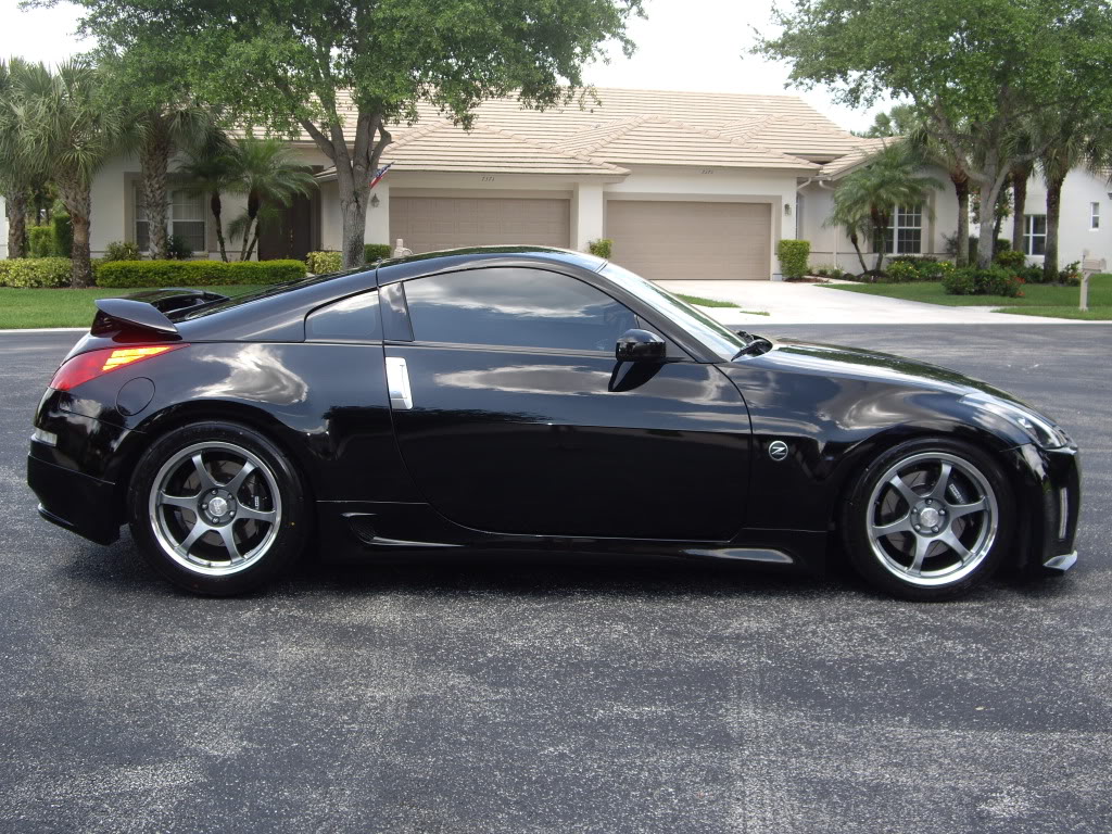

Can't really see the meatyness, but it's there:
SSR Comp-H's F 18x8.5 R 18x10.5 I don't remember the offsets
F 255/40/18 R 295/40/18
Falken RT615
