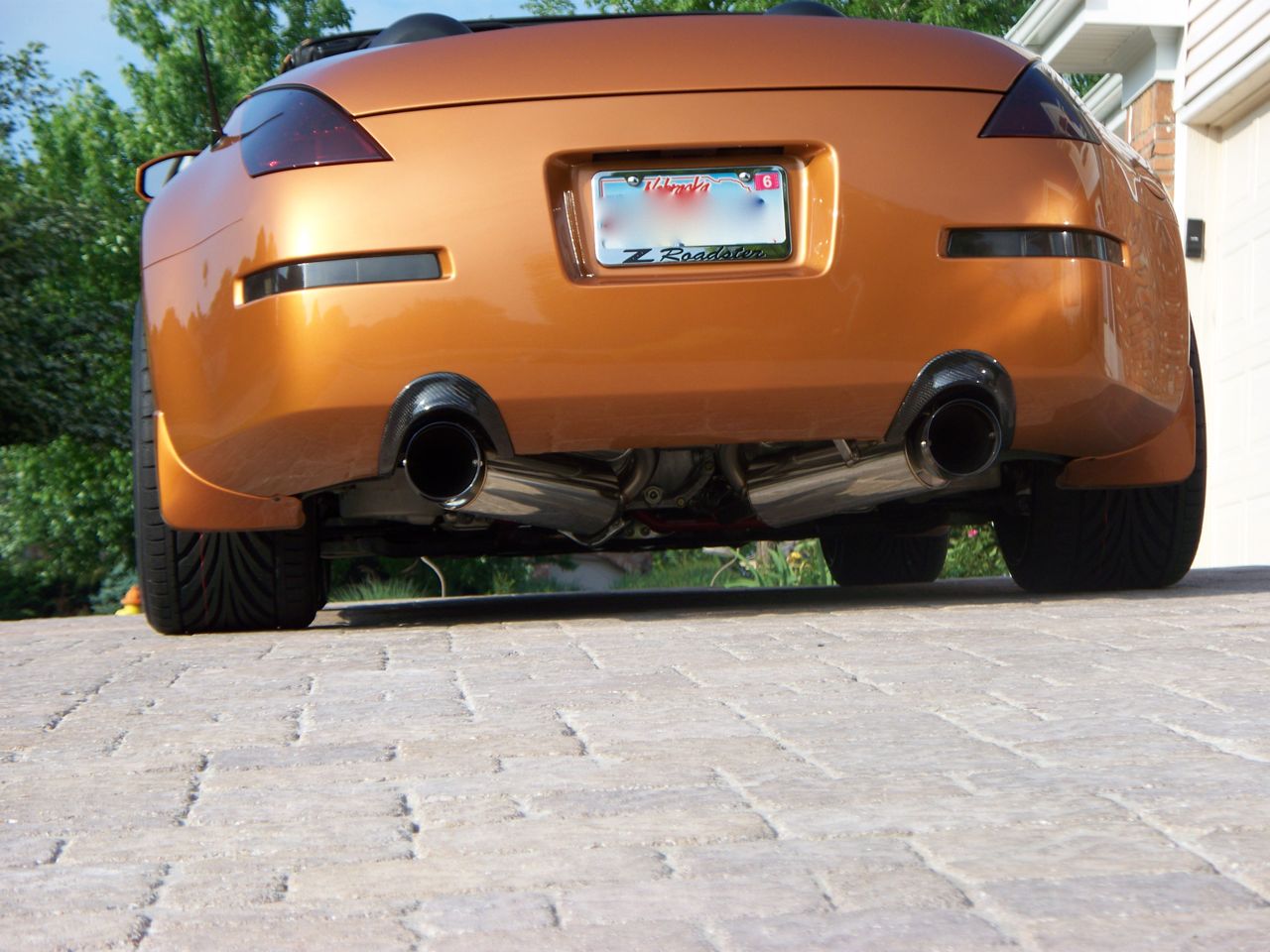

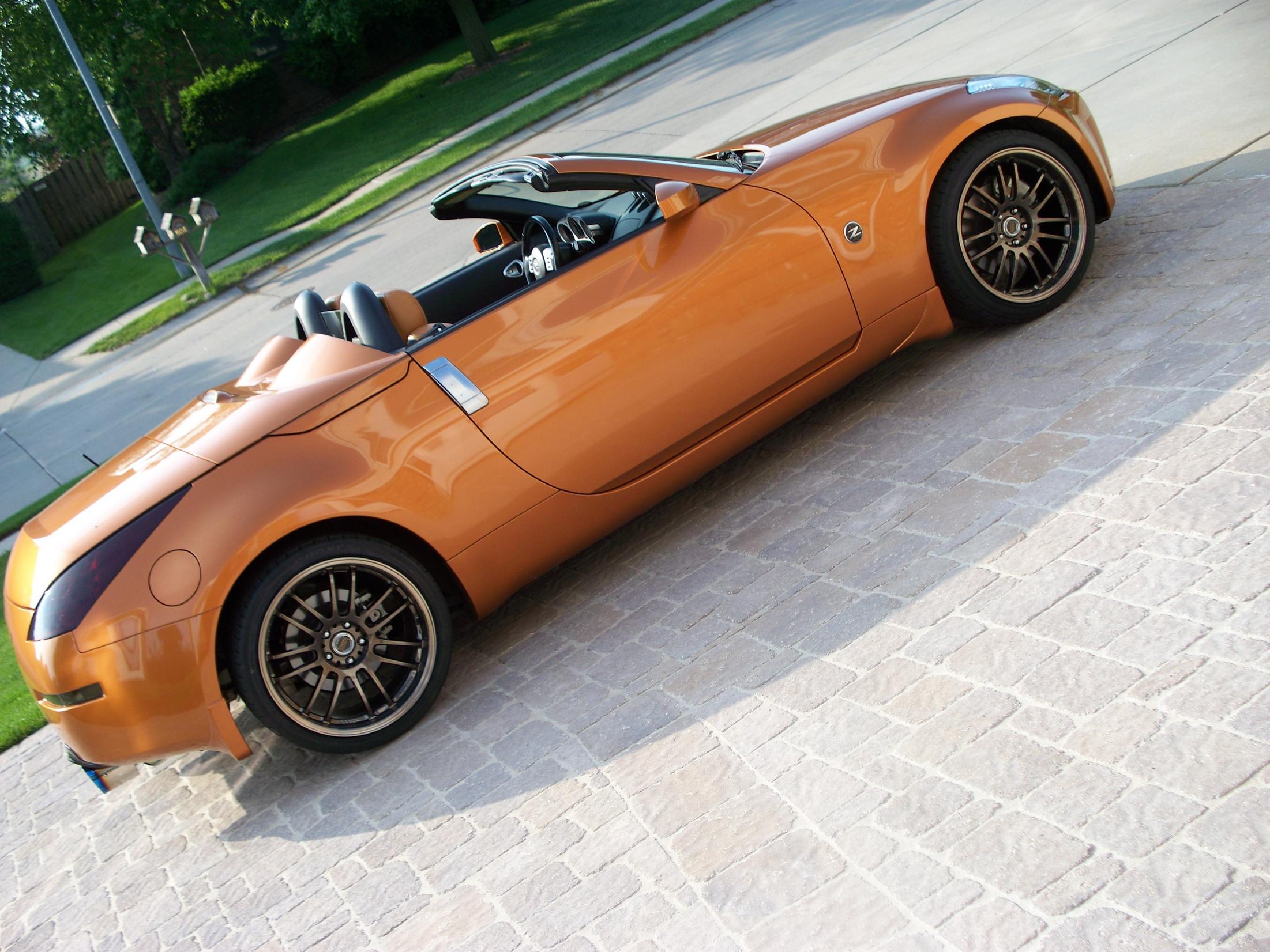

I know it needs lowering

Absolute sickness. What offset and tires are you running?

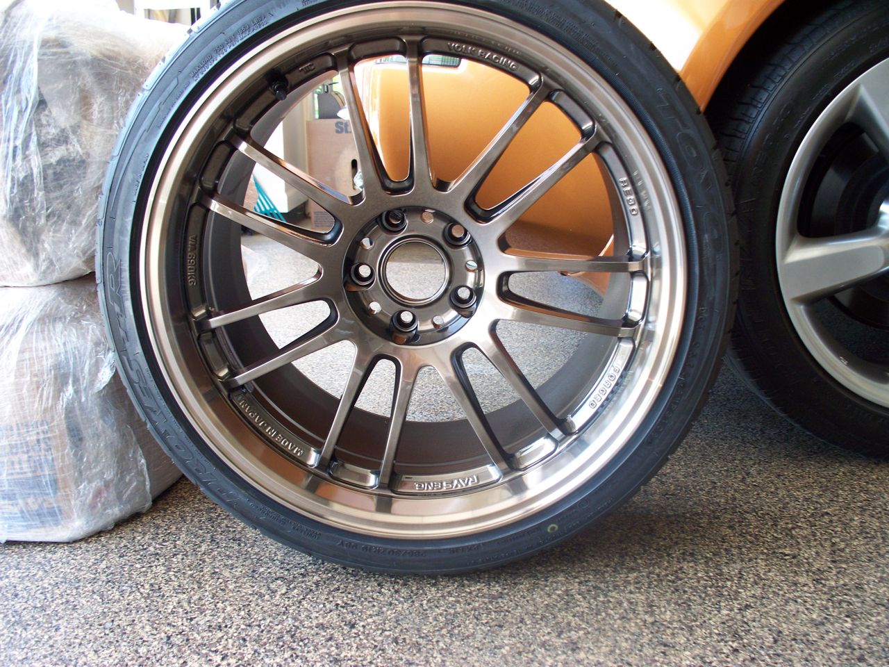

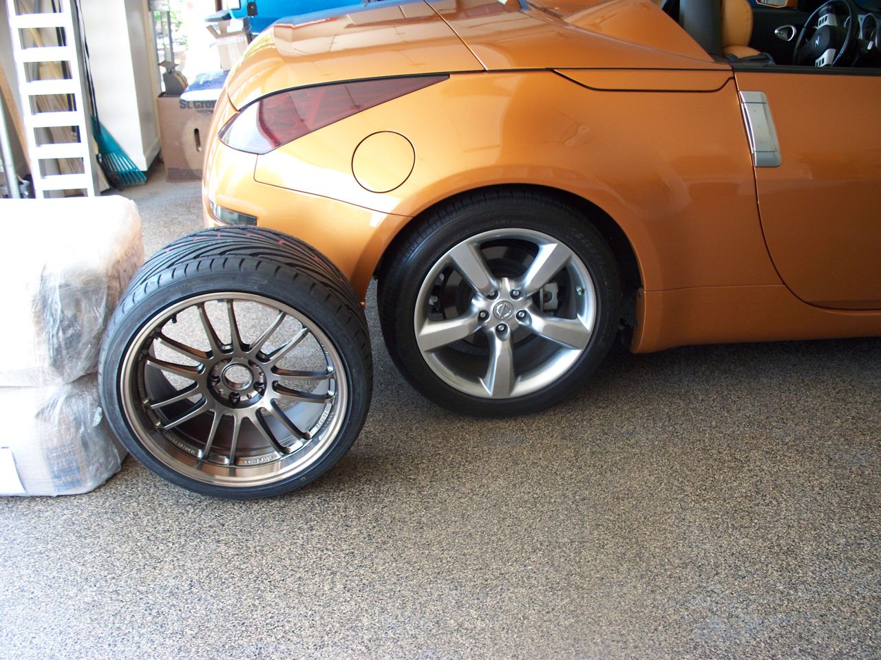

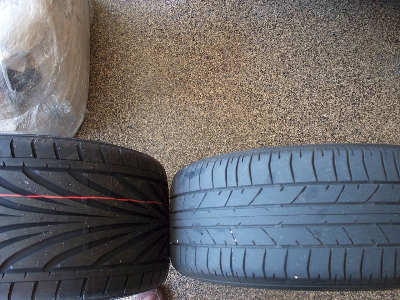

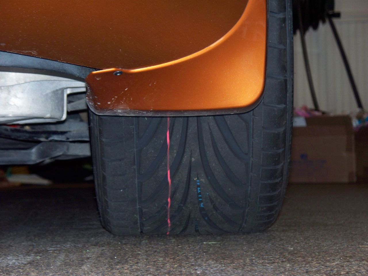

the offset is 25 - rear
and 30 - front
the rims are 11" rear and 10" front

WOW! Looks good! Curious though, the rear looks to have a smaller rolling diameter than the fronts. What size tires are you running?

you are correct. Good eye
here are the sizes
285/30ZR19 98Y RD
255/35ZR19 96Y RD
Forged Performance was concerned that any larger of a tire might have clearance issues

How is that not exploding your VDC?
285/30 is 1" shorter diameter wise from stock on the rear and 3.6% off stock at 60mph. Your fronts are near perfect OEM diameter...so that means you went from a +0.7" stagger F/R (dia) to a -0.3" stagger F/R.
People have been running 285/35, 295/35 or 30...and even large with some fender mods/camber. I dunno, 285/30 seems like far too small a tire out back especially considering your fronts did not scale down.
Sick wheels nonetheless...
