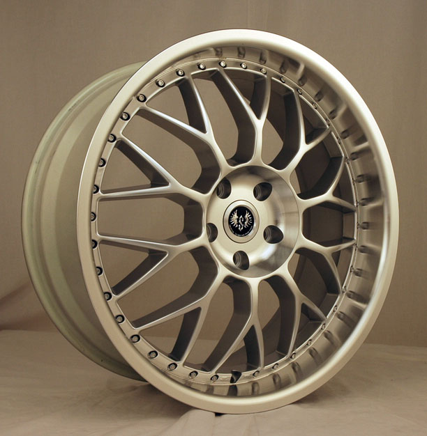

well after doing a further search i found these wheels for the Z, what u guys think with the high offset in the rear. i also want to drop my car but looking at my car i dont know how much room i will have to play with the kit on. u guys think i can drop it with 19's , the wheels on it now are 17s . TIA
19x8.5 et20
19x9.5 et35
<a href="http://s2.photobucket.com/albums/y22/airride07/?action=view&current=nowheel.jpg" target="_blank"><img src="http://i2.photobucket.com/albums/y22/airride07/nowheel.jpg" border="0" alt="Photobucket"></a>
hey guys need some feedback from the Z family. i want to get this right.
what you guys think of these wheels for my Z. here is a pic of the potential wheel and my car. also what u guys think of the offset i want the wheels flushed with the fenders. what u guys think
wheels specs
19x8.5 et20 2inch lip
19x9.5 et 25 3 inch lip

are these the four hundred dollar ones on ebay? I actually like the design, but if they are ebay brand, im sure people will tell you to buy volks. Also, these wheels may not be good quality and pretty heavy. If you do end up buying these, please let me know and post some pics.

Those sizes and offsets won't be flush. Keep looking, get lower offests (and/or wider wheels), or run with spacers (last resort).

If you want flush , those wheels have FAIL written all over them.

I actually think these wheels look pretty nice. Why would you say its a bad decision to get these, quality?? Or weight? And 19's with 20 offset seems pretty flush to me.

I had something similar to these on my car, I forget what the offsets were. I will admit they were the ADR ebay special, and I can not complain about them. I beat the **** out of them while I had them with no bad results. The only bad thing that happened was the clear coat started to peel on the lip. If I drove my car in the winter, I would use these as winter wheels in a heartbeat.

Yes, the offsets are not bad...my Axis have same. w/o spacers my fronts are almost flush (could use a 5mm) but the rears require about a 10-15mm spacer.
It is not easy finding wheels that offer an offset less than 20 except real high end such as Volk, Work, iforged, etc. As long as you can stay no more than 20 fronts and no more than 25 rears (assuming 8.5-9.5) then you will be fine.
As for the wheels, they are not horrible, but you can def do better. If you want to go cheap, look into Rotas before you get these.

Running a stretched tire on those size and offset wheels will not look good IMO. I think with that wheel fitment you would be better off getting fat tires, unless of course if you plan on getting huge spacers.
