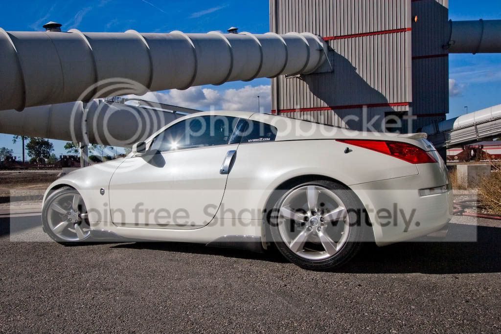

In this picture I had 225/45/18's up front and 245/45/18's in the rear. I could have gone wider though.

Car looks good man. DO you have any pix of the back wheel gap?? what suspension are you on??

Thanks. I'm on Eibach Sportline springs with stock shocks. I'll try to find a picture of the rear wheel right now and post it. I had about a 1/4" gap between the tire and fender if you look at the wheel straight on. The biggest gap though was from the tire to the fender horizontally since I needed spacers. I'll try to find a pic of the back wheel right now

Same suspension as me. I might grad a small set of spacers if needed but for the deal im getting i cant change the size of the wheel. I love the white z tho

Here's a good shot of the rear wheel
