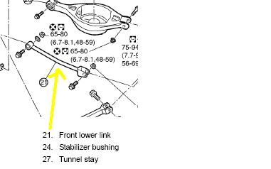

Does anyone know what this part is called? I need to get a replacement. Some lady cut me off and i hit a curve, and i'm hoping this is all i have to replace.

that is called the front lower link, according to the service manual.

if you go to order the part from nissan it'll be a pain in the *** to get it. they call it a lower a arm (least when this happened to me last year) the part is about 50$ but will take forever to get it. just order the traction/camber arms if you have the money and you will have a replacement arm faster.
would it be the REAR lower link then, since it's in the rear?
some guy said it was the camber rod.
and where can i get this adjustable one? or where can i buy a replacement.
So far, i've heard
Lower A arm
Lower link
camber rod
Old Oct 12, 2003 | 04:10 PM
2003z's Avatar
2003z
Posts: 4,959
From: Atlanta
So far, i've heard
Lower A arm
Lower link
camber rod
No, the rear upper link is the big aluminum piece that the spring perches on. I believe camber rod is the popular term, but nissans terminoligy in the service manual (and if you are ordering a part) is front lower link. However, if you are trying to buy a used one, you might want to make a post saying you are looking for a stock camber arm, since several people are getting adjustable ones and may have them laying around.

Please select a corresponding number from the illustration below to view the details of that part.
1) Knuckle Right 2) Bushing No. 1 Back 3) Bushing No. 2 Back
4) Bushing No. 3 Back 5) Bushing No. 4 Back 6) Upper cntrl arm Right
7) Lower cntrl arm Back 8) Lateral arm Back 9) Radius rod Back
10) Stay bracket Right 11) Susp crossmember 12) Stopper Stopper Back
Description Year List Price Your Price
Lateral arm Back 2003 $34.13 $25.60

I recently purchased a used Z and found out that that same lower link bar is bent!
I'm upset. I'm hoping this is the only major part that is wrong.
Is the front lower link a black metal bar around 1-2cm's in diamter that aligned parallel to the axle? its roughly about 8-12 inches long and is slightly bent looking?
Could someone give me a part number so I can find pricing? I'd so appreciate it.

yeah, it's slightly bent, you can kinda tell in the picture.
