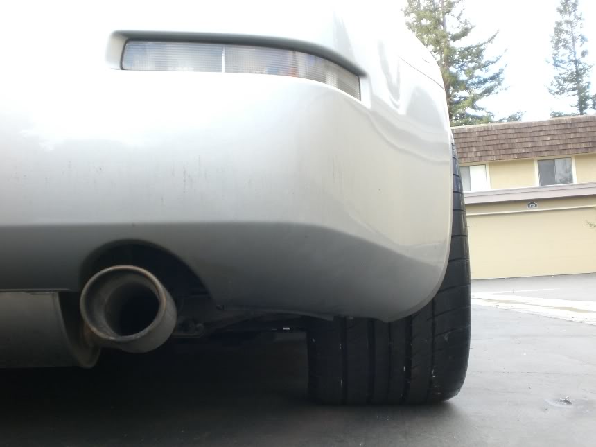

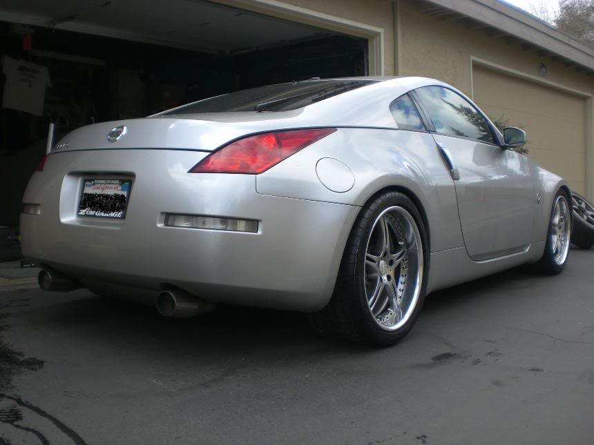

It doesn't, I was asking because of the offset. I was considering the Enkei RPF1 in 18x10.5 +15 for track use, but it seemed like 295 was the max in the rear with a significantly rolled fender. Plus I'd never fit that 295 in the front, and I like a square set-up.
You think the 18x10.5+15 will fit with a 305 without a lot of fender work? I don't.
Here are my 19x10.5 with a net +18, and it rubbed hard. Car is lowered a bunch, but also has a lot of camber.

Same wheels DO fit on my wife's ZR as a 19x10.5 net +28, though the car is not lowered:
