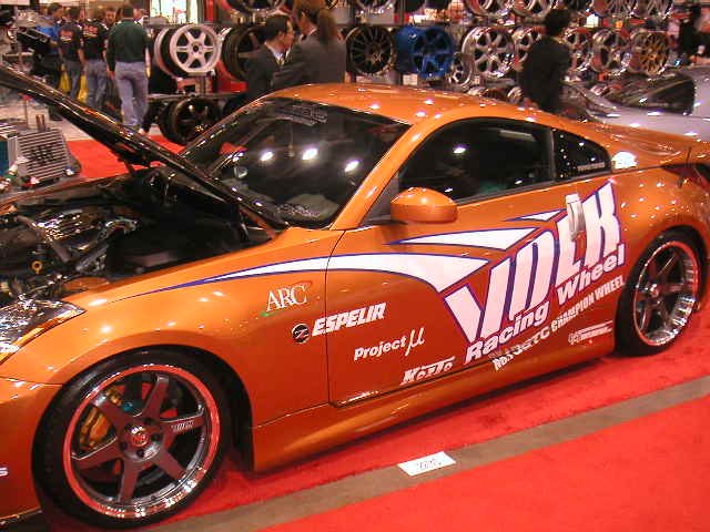

Anyone know the name of these Volks. They look like the LE37T but the lip looks bigger and more polished. Any idea on size?

Id guess those are 10.5s in rear possible cause that is a huge lip, definitly LE37s tho.

They're the special edition ones I believe, LE37T, they have a polished lip and different paint colors.

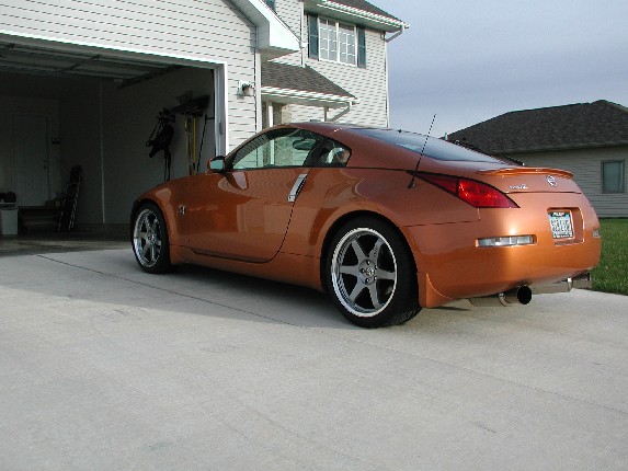

I would say they are the Gunmetal LE37Ts with a 10.5 rear with a +22 or lower offset which would require a fender roll. I have the Silver LE37Ts but only have a 9.5" rear with +22 offset.

I have 10.5 inch wide Rays Gram pro lights 57F ... 19"s.. no fender roll.. just a proper offset. The offset for the rear is +29 if your going with a 10.5 incher in the rear

Hi, how big is your lip in the rear with +29, is it the same as that lemans sunset in the picture? and does it rub the tire in the front or rear? any problem? thanks

thanks... no rubbing, no problems yet .. the rear lip is 4 inches
