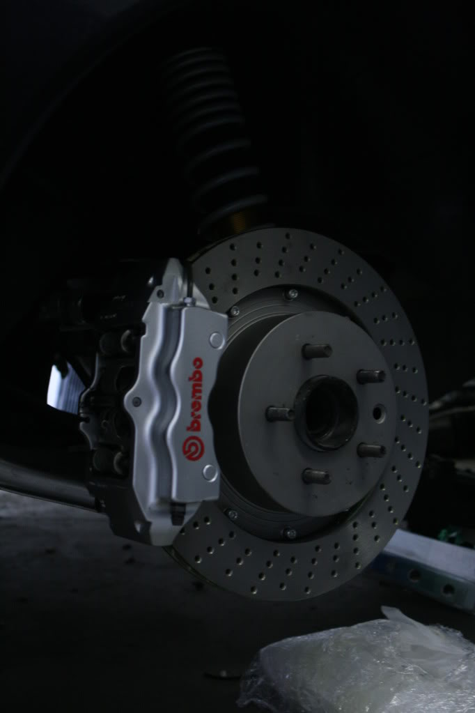

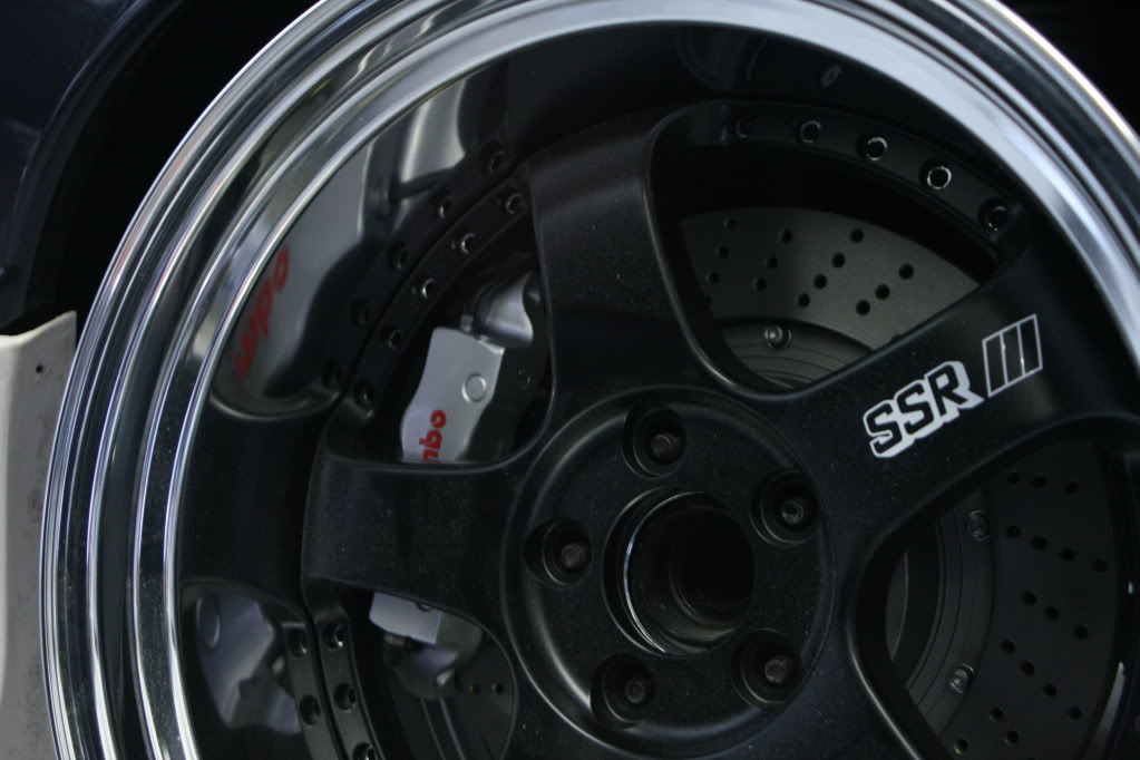

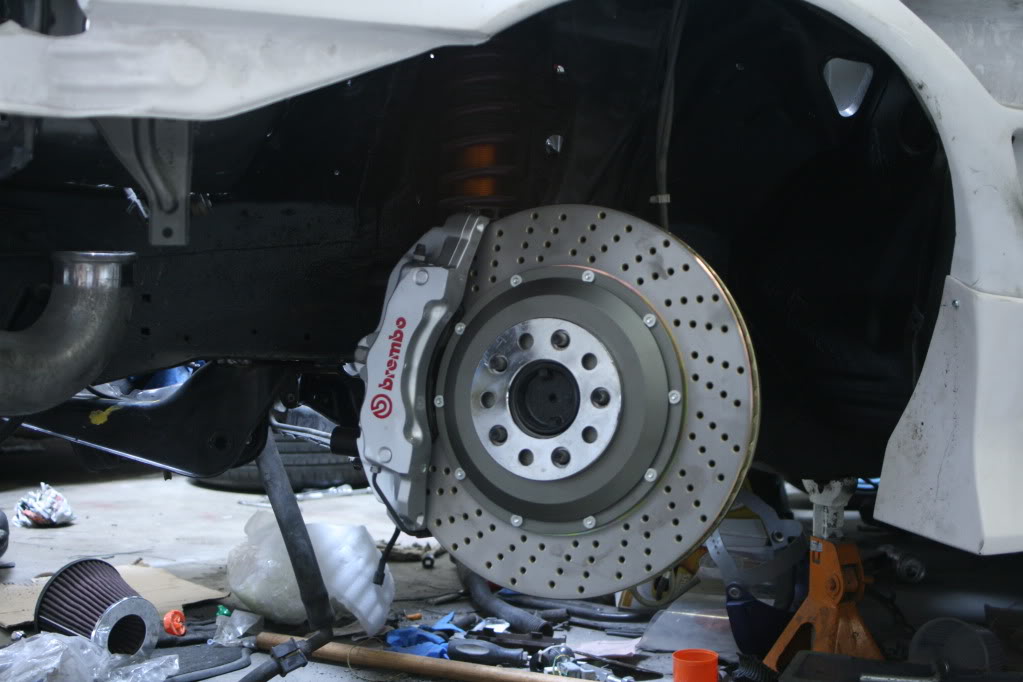

I am not on GTR 6/4 set up. Mine is Cayenne S with custom bracket. 380/345. I am going to test out the following and see how they'll fit.
Work emotion CR-Kai
Enkei RFP1
Rear fit my SP1

ssr type-f in 18x10.5" +15 FITS!~ with tons of room to spare.
