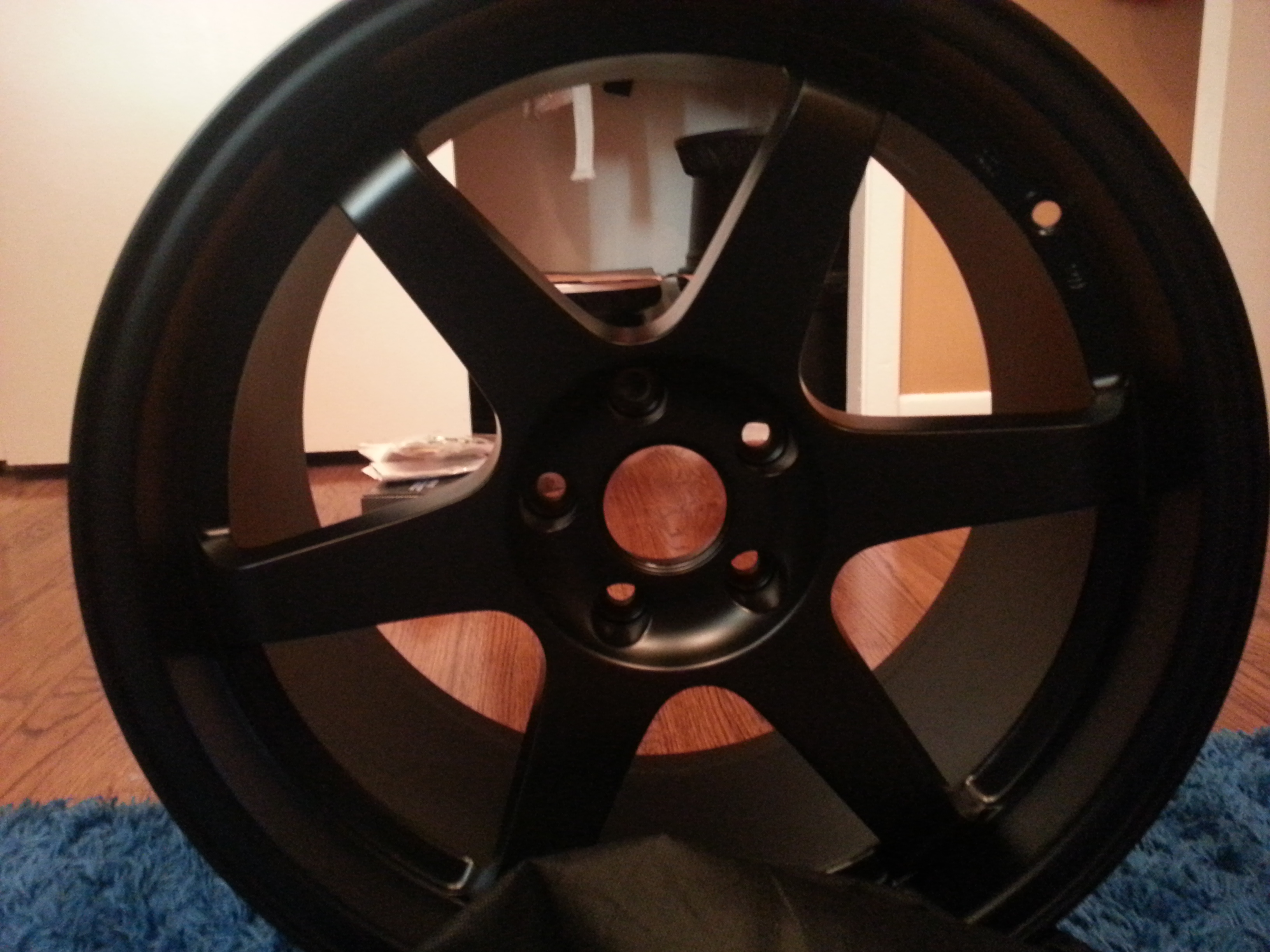

Question New Wheels, Need Help With Tire Sizes
Hello!
Today, I received my Varrstoen ES221 wheels. The rear size is 18x10.5 and the front is 18x9.5 (+22 offset on all 4 wheels). I've tried to find good sized tires to fit them but people's answers are all over the place. So now I need some help deciding on the right sized tires for my preference.
My current wheels are 17x9.5 and 17x8.5. I've been running with 20/25mm spacers My fenders are also rolled.
I really don't want them to look stretched with the lip sticking out. I prefer the tires to be even with the wheels (if that makes sense).
Any and all suggestions and responses are greatly appreciated!
Thanks

Likes: 277
From: arizona
265/275 up front.
285/295 rear

Originally Posted by Arrtus
Hello!
Thanks
You have a couple choices here....
First thing you will want to do: REMOVE THE SPACERS. +22mm is tight enough so that your wheels will not stick out. If you still have room (which I doubt you will if you go with the big meats, below), you can always re-install the spacers.
On tires, you could go with the aggressive fit that turboed350z recommended OR you can go with the tried and true, relatively conservative setup, 245/40-18 FRONT, 275/40-18 REAR.
MY preference (MINE ONLY), based on my mechanical setup (suspension) is going with the latter. (And note that the conservative setup is about equal wheel/equal tire section width as you noted in your request.) If you want the meaty, aggressive look with the off chance of increasing understeer, go with the former. Either work fine, however.
Mic
Mic
