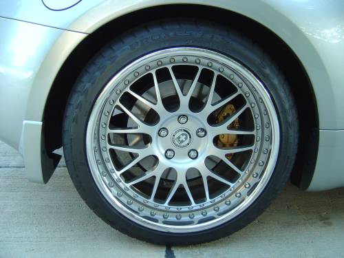

nope have 275/35 on 19x11 so 10.5 will work fine.
Attached Thumbnails 275/40 on 18x10.5s...too small?-dsc00041.jpg

wow thats really stretched on there... as you can see, itll fit, but this is a 275 on a 9.5" tire which some would say is the proper combination.
you can see the difference in the sidewall.
Id bump it up to a 295 IMO... I think itd ride and handle better, just cost a few extra bucks, but if you only plan to run a 275 just get a 9" to 10" rim no?
