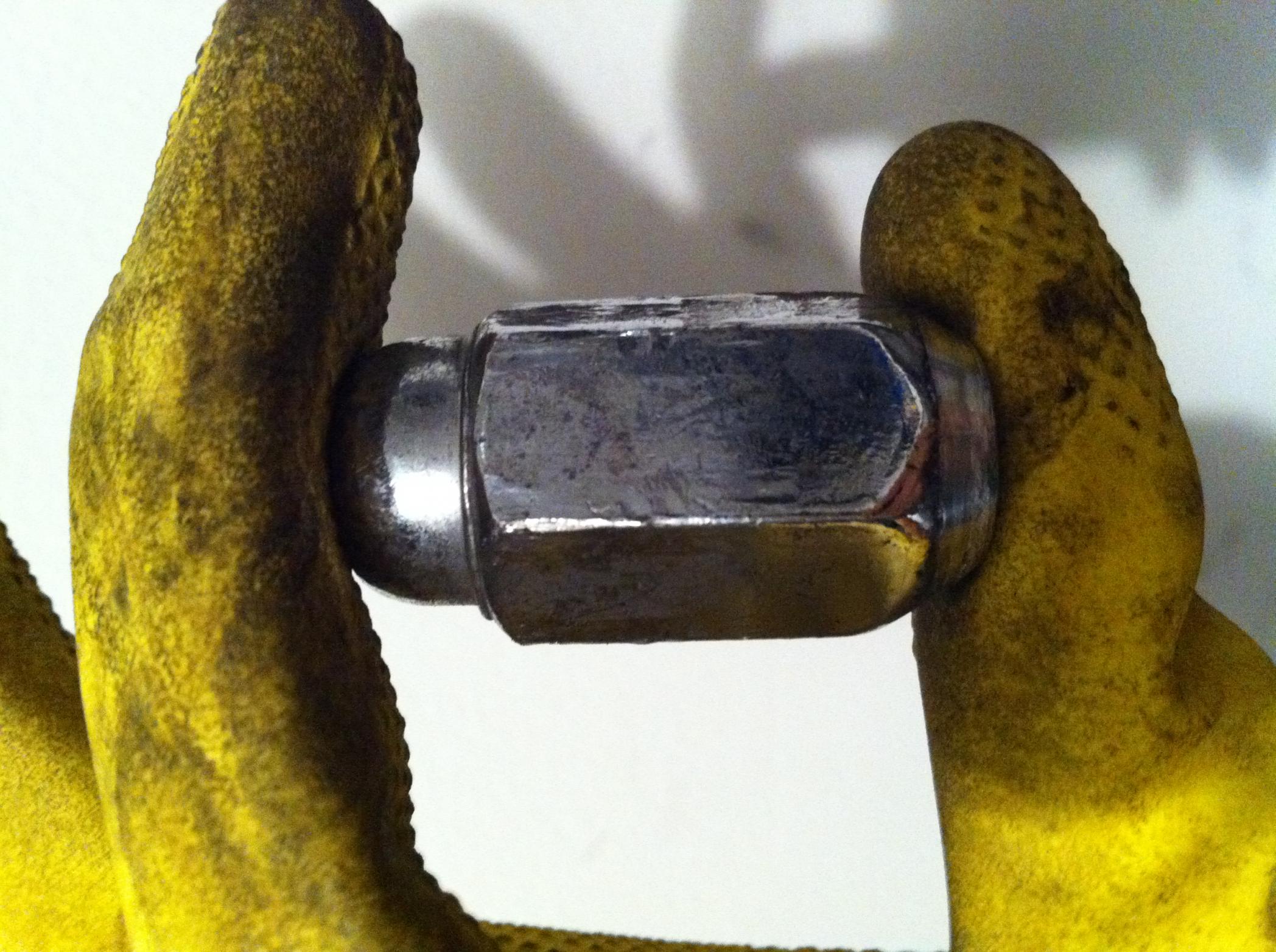

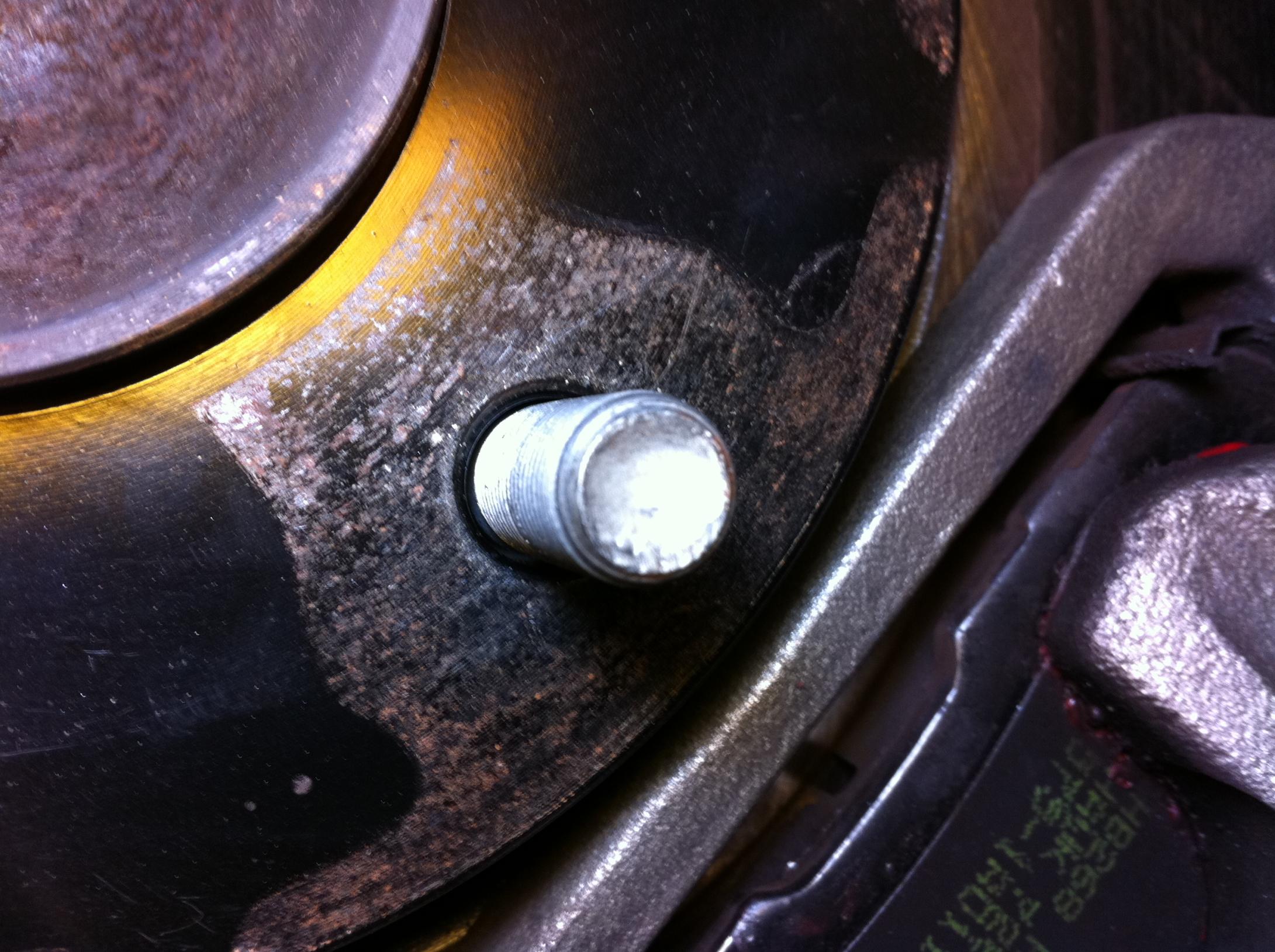

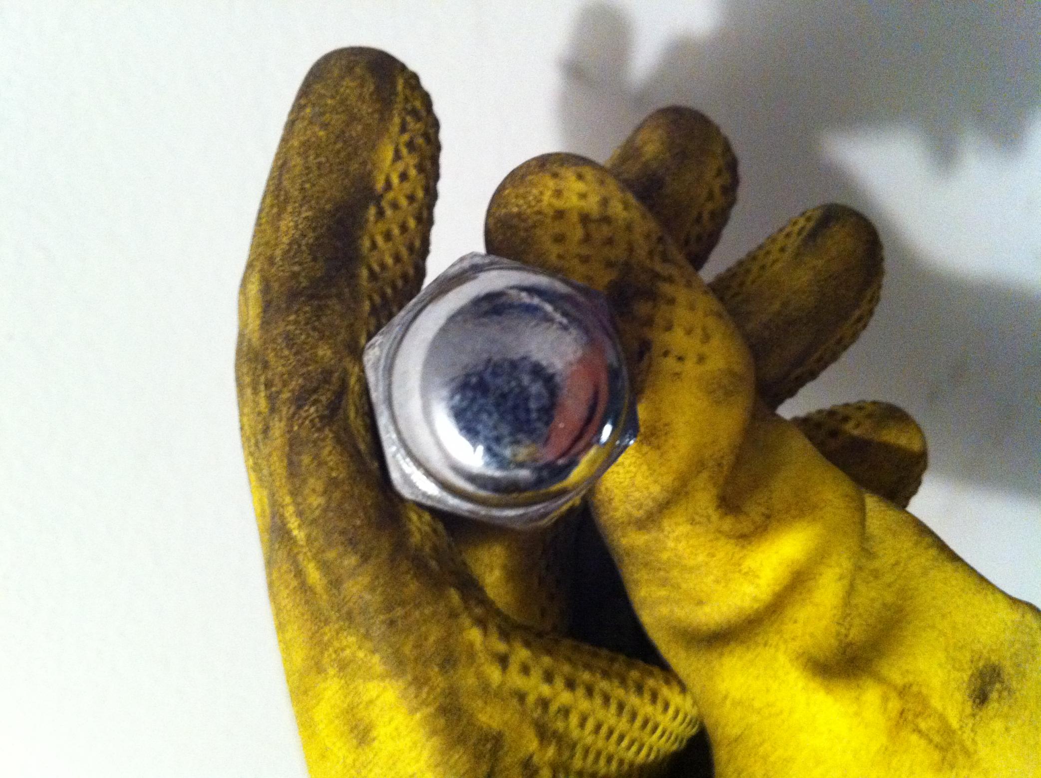

Ok, i took some pics of the lug nuts and the thread.
At the tip of the studs, all four corners, there are some scratches which i assume is made by the deep end of the lug nuts.
Attached Thumbnails lugnuts keep loosening-img_0519.jpg   lugnuts keep loosening-img_0520.jpg   lugnuts keep loosening-img_0521.jpg   lugnuts keep loosening-img_0522.jpg   lugnuts keep loosening-img_0524.jpg

the nuts seem like the stock ones

Those do appear to be OEM lug nuts. If you thread them 1/2 way onto a stud (without the wheel on) is there any play in the nut, i.e. does it feel loose?
Also, can you thread the nut all the way on to the point where it is tight and is tight up againsts the rotor and hub or does it bottom out before that point?

My OEM lugs are MUCH shorter than that:

There are two types of lug nuts depending on model year, wheel type... CLICK HERE
If OP had the short style lug nuts, then I could see where he would have a problem with them bottoming out on long studs. Since he has the deep style, that's not a problem. If he's supposed to have the short ones, the problem could be with the long nuts not getting enough thread engagement.
