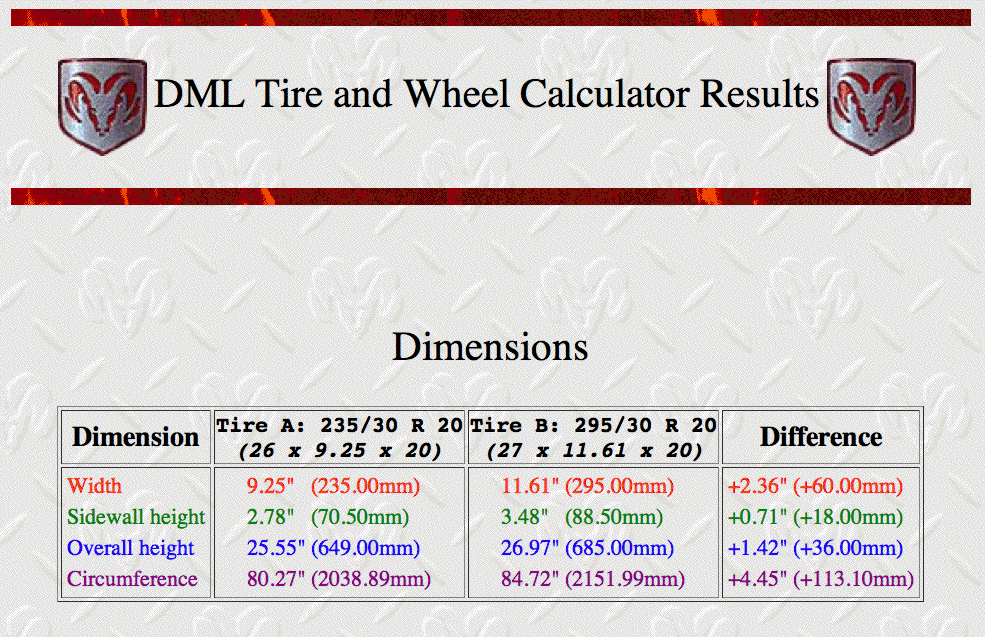

Thinking of something different.
I'm currently running 245 & 285/20's. I love the stance of the 997 Turbo and would like to know if these sizes will work for our cars.

That's a lot of stagger. If your car has VDC/TCS that will be too much and cause problems.

I'm running 245/35/19 and 295/30/19 with 0 issues with TCS. 15mm spacers up front.

The stagger on your setup is 0.2" which is actually at the low end of the acceptable range. OP is talking about a setup with 1.4" of stagger, that's way higher than the recommended 1" max. You've got a 35/30 mix of profiles, he doesn't.

Difference in circumference is 5.5 percent. VDC will not like this.
