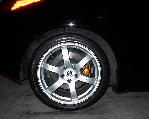

Old Nov 30, 2003 | 02:10 AM
joust75's Avatar
joust75
Posts: 5,096
From: Sesame Street
Default Re: Track Wheel setup
Originally posted by SD350ZEE
So with the 8" front and 8.5" rears
Should I go
245/40 255/45
245/40 265/35?
Anyone still got that handy dandy formula lying around?
Okay heres the deal Stock is f225/45 r 245/45
I didnt like the huge sidewall height on the rear tires so I went to 255/40 on the rears. Looks much better now. I havent changed the fronts yet so VDC goes a little screwy with the break in stagger. When I get my new fronts i will go 235/40 and the car will be back to normal. Smaller sidewall but just enough that I dont have to worry about fudging up my wheels
The point is The tire size you want depends on the look you want. You can do a taller sidewall or a shorter sidewall. An easy way to avoid screwing up vdc dynamics is to take the stock tire specs and whatever you add to the width and aspect ratio of the rears you add to the fronts.
I learned the hard way! First I went with 255 by 45. My vdc was off and the rear wheels looked like those of a tractor. so I went with 255 by 40. VDC is still a little screwy but at least it looks better. once I get my 235/40 fronts the fronts and rears will be back into proportion.
