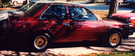

I once did this to my first car, an 83 sentra, back in 1984. I drove the car for 3 years afterwards with no structural, rubbing or paint issues.
I taped off the outside of the fender with masking tape to avoid accidental damage, and used an air grinder with a flexible wheel, and just slowly worked at it til the factory lip was down to about 1/8". I was then able to run rwd offset wheels on the back and give the appearance of a stagger. Not bad for 20 years ago!
Attached Thumbnails Grinding vs. Rolling?-mike-golding-s-83-nissan-sentra.jpg

Dude that Sentra is pimpfukintastic.
