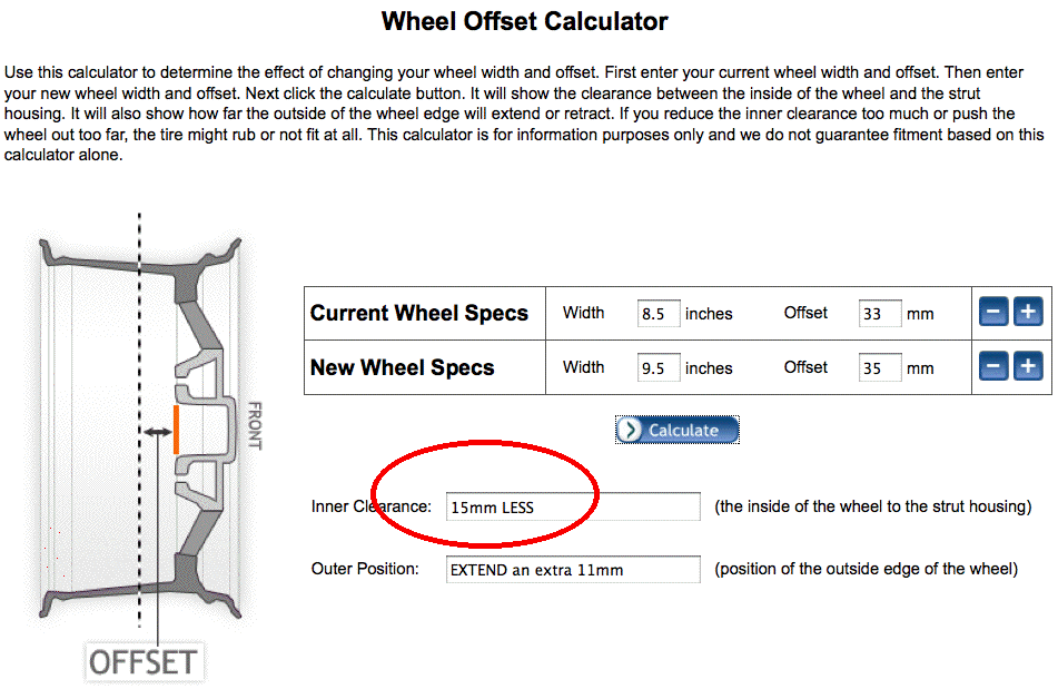

Rear wheel inner clearance is 15 mm LESS than OEM. Is this your intention?

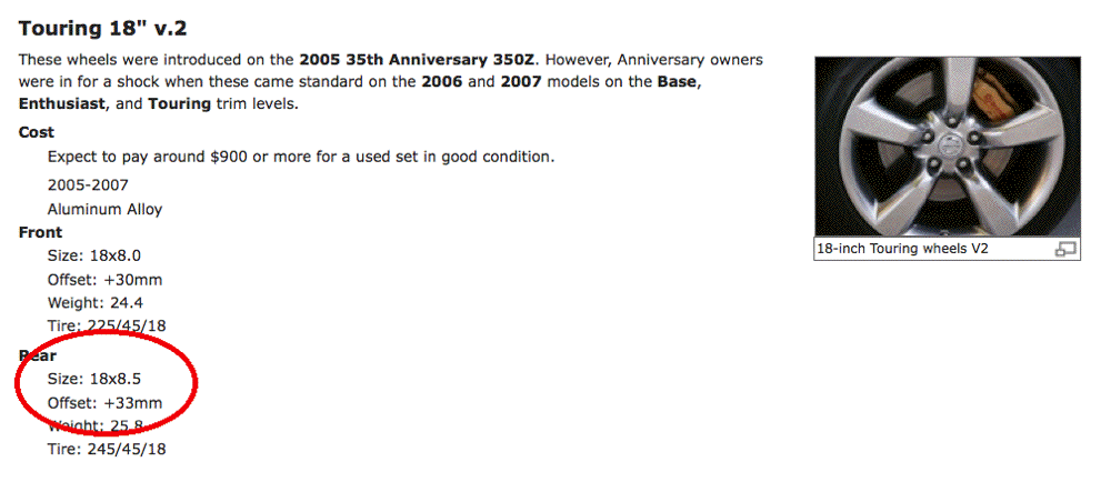

Here are the numbers that I used.
Hi David,
Thank you for the detailed response and the pictures of the wheel offset chart.
One inch variance in wheel width (8 1/2” vs. 9 1/2”) is a 25mm difference. If the wheels’ offset (the 8.5 and 9.5 width) is the same (about +34 here, splitting the difference between +33 and + 35 offset), you can expect the two different wheels’ center-point to set pretty much in the same position with a little more extension to both the inside and outside of the wheel well. Duh! That’s why you see the 11mm extension to the outside and the 15mm extension to the inside in the offset diagram you posted.
I’m asking this question wondering if you have ever noticed any problem with extending the inner wheel rim 15mm’s (about ½ inch) inwards?
--Spike
